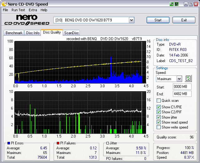

Postby dodecahedron on Tue Feb 14, 2006 3:57 pm
well, burned 2 CDSpeed test discs to try this media out. one at the rated 8x another at 12x. i'm no expert but these seem to be pretty good. the 8x is nearly as good as the 8x burns of my TDK YUDEN000 T02 and Verbatim MCC 003.
CDSpeed test disc burned at 12x
burned at 12x DiscQualityScan.png (56.7 KiB) Viewed 1818 times
RITEK R03 - CDSpeed test disc burned at 8x
burned at 8x DiscQualityScan.png (55.69 KiB) Viewed 1819 times
