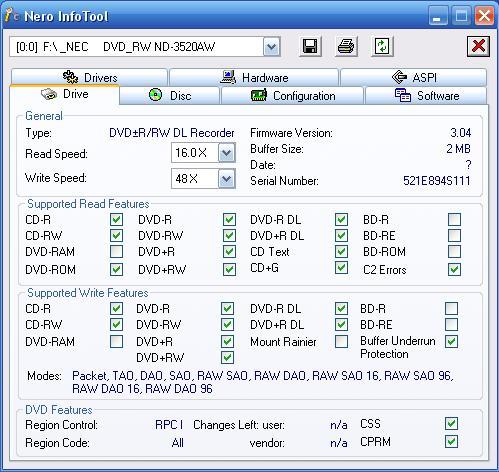

Thx to the guys over at cdfreaks.com for the info:
http://www.cdfreaks.com/news/11631
it also removes the region protection and/or rip lock remove
flashed mine and its working great
flashing program (win32 gui): http://binflash.cdfreaks.com/download/1 ... wingui.zip
firmware page: http://club.cdfreaks.com/showthread.php?t=133940

Postby hoxlund on Wed Apr 13, 2005 12:19 am
here is nero infotool screenshot
yes dvd-r dl i forgot to add that in
NEC 3520 - RPC1.JPG (60.89 KiB) Viewed 1866 times

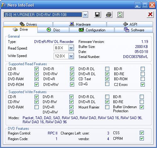

Pionner DVR 108.JPG (62.79 KiB) Viewed 1879 times

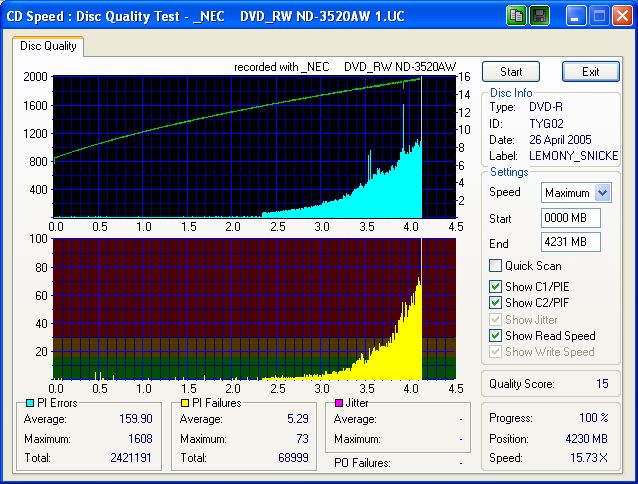

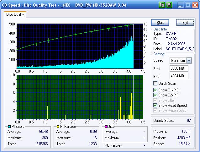

Postby dodecahedron on Wed Apr 13, 2005 1:41 am
new the important question remains:
how well does it do scans? how reliable are they?
Postby hoxlund on Wed Apr 13, 2005 2:09 am
here some results, TYG02 burned at 12x on pioneer dvr-108bk 1.19 firmware
Postby slimeballzz on Wed Apr 27, 2005 2:52 am
Wow why do your results look so much better than mine? Is it the firmware?
slimeballzz
Posts: 23
Joined: Thu Oct 03, 2002 1:52 am
Postby hoxlund on Wed Apr 27, 2005 11:17 am
mine were burned in pioneer, and also whats up with your firmware, it shouldn't read like that
Postby slimeballzz on Wed Apr 27, 2005 10:32 pm
Oh oops my bad. Read the post and assumed you burned and scan with the Nec.
