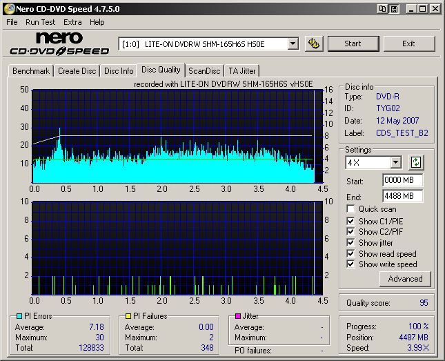

Burning TYG02s with the Pioneer 212D, I'm getting really inconsistent scan results and with the results being no where as good as the ones I've seen from other posting and reviews. For this media, I think others have been getting around ~1.20 for average and total of ~22,000 for PI errors, and total PIF of only ~300. All my scans have much more errors. Even when I slow it down and burn this media at 8x, it's still not very good with about the same quality. Can anyone please explain to me why I'm getting inconsistent and not so good results? I thought TYG02 is supposed to be one of the best medias??

You have some spiking in your scans, but they are still well within acceptable levels. Media is always variable in quality...

I also think those burns are still good

I think those scans are OK. There is some PIF clustering near the start of your first scan, but that could be the result of some marks on the disc. Have a look if you can see a smudge or speck in the first cm or so.
If you go to the "advanced" tab, you can activate jitter scanning for your drive. This is automatically performed in a separate run after the PI/PIF scan is complete- be patient, it only takes a few seconds.
Also a transfer rate test (TRT) will give you additional information on the readability- but with these scan results, I don't really expect any problems.

Yea most ppl are telling me it's acceptable values, but I bought TYG02's with the intent of it being excellent quality. I'm getting much better burns with these ProdiscF02s I have. If one disc from a cake box is not so good, is it most likely the case that the entire box is of the same quality? cuz so far, i've burned about 10 of them and each one has not been personally very satisfactory.

But they just aren't very good compare to what everyone else is getting.. I don't get it.
How much of a PIF cluster is considered 'Bad'? Talking about PIE now, I notice every time i burn something, there's always a lot of PIE at the beginning and it gets less as it progresses, and it generally goes up again near the end. However, it doesn't look like that's happening with the LiteON.

did the TRT before and it reads fine.

fleshie wrote: But they just aren't very good compare to what everyone else is getting.. I don't get it.
Please don't fall into the trap of thinking that the scans you see on Internet forums are in some way "average".
Some users post scans whether they are good or bad, but many people only post their best scans, because they see it as a competition. Some other users only post scans when they think they're having problems.
This doesn't really add up to "average" scans.
