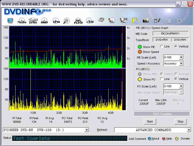

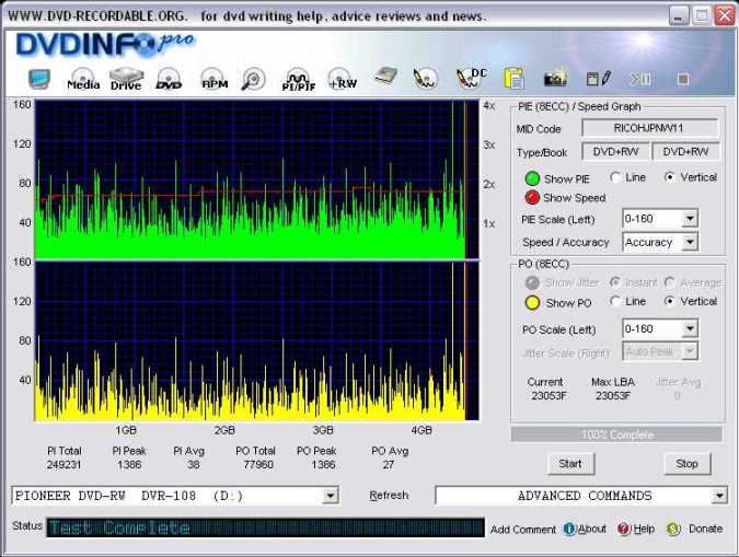

Just out of curiosity, I tried burning the same ISO to the same physical media using NERO 6.6.0.1 and then DVD Decrypter 3.5.1.0.
Looks like PI and PO errors are higher with NERO. (the first pic is with Nero, the second with DVD Decrypter) . The disc burned with DVD Decrypter appears to play OK. This is strange, since the Nero burned disc errors aren't that high.

Postby rdgrimes on Sun Dec 05, 2004 6:45 pm
The differences in those 2 scans is insignificant, and can be attributed to normal variation between burns. Also keep in mind that many RW discs need to be burned a few times to get "broke in", so error rates will vary for that reason too, as well as whether the disc was full-erased or quick-erased.
But the bottom of this issue is the player's ability, or lack of it, to read this RW media.
