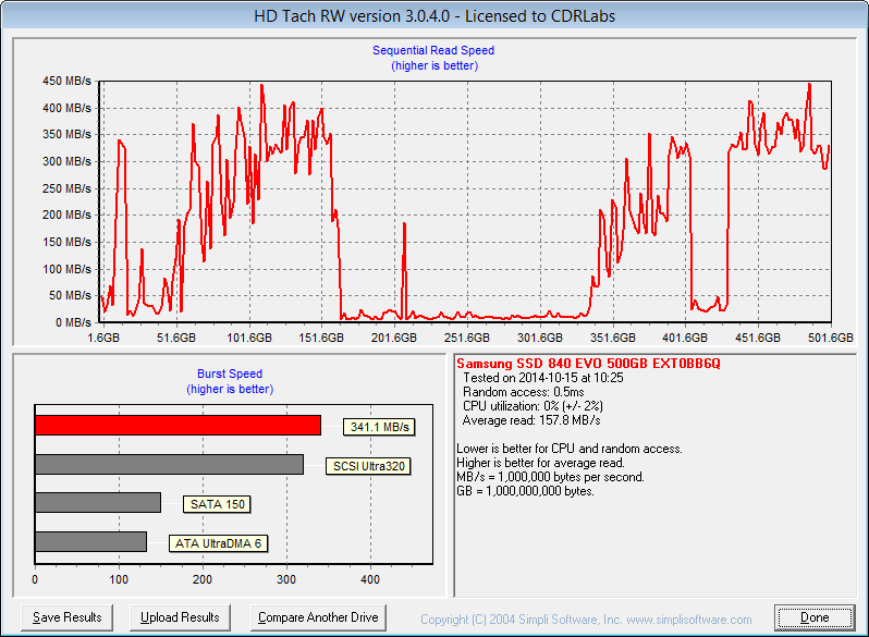

Okay, it took most of the day but I updated the drive in my laptop. Here's the performance before:
Samsung EVO Pre Optimization.PNG (38.3 KiB) Viewed 21813 times
Take note of the spots where the read speeds drop to almost nothing. Yes, I have lots of old data.

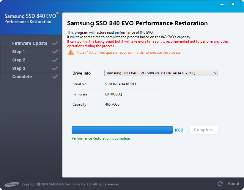

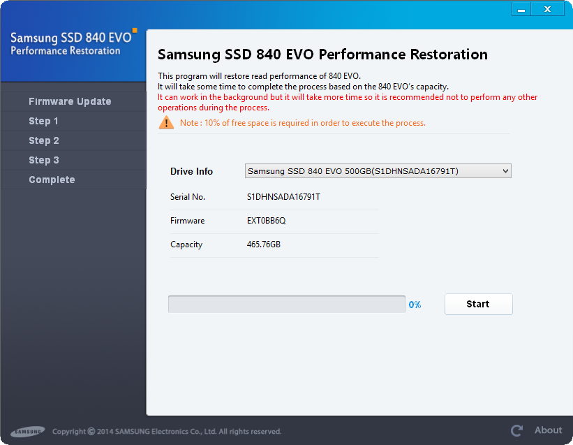

Optimization process takes forever. Also, don't plan on using your computer while its doing this. The performance is horrible while its working.

And the performance when its done. Much better!

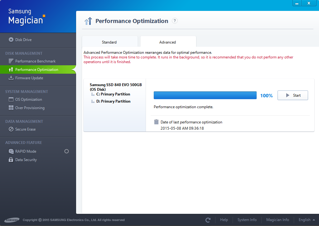

Magician 4.6 includes an advanced option under Performance Optimization that "rearranges data for optimal performance".
Samsung 840 EVO Performance Optimization Advanced.PNG (87.39 KiB) Viewed 20745 times
The optimization is fairly quick. It's nothing like the last "fix" that took nearly all day to run. Afterwards, the performance looked like this.
