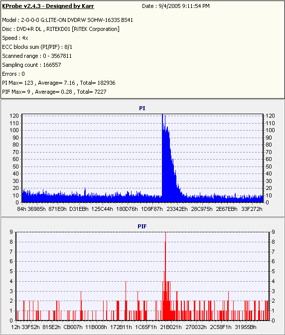

Postby cnlson on Wed Dec 14, 2005 2:37 am
Ritek D01 works fine for me...
fine scan
Ritek d01 090405.PNG (12.21 KiB) Viewed 2009 times
burned @ 4x

Postby Phoenix '97 on Wed Dec 14, 2005 11:40 pm
Odd, it seems that the writing strategy for DVD+R DL for 2.1A is later than that for 2.TB (1.27 vs. 1.26, see here:
http://liggydee.cdfreaks.com/stratinfo/2/0 )
Does writing at 4x give better results than 2.4x? :p
