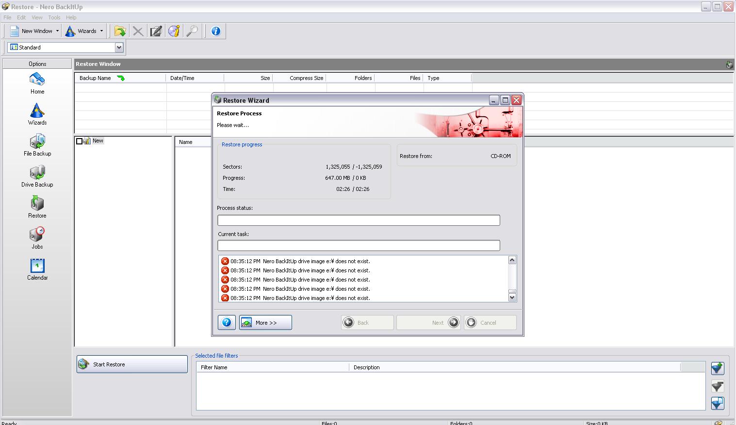

Postby KEN2 on Tue Dec 13, 2005 10:52 pm
Craig,
I just downloaded the updated version of Nero 7.0.1.4 to see if BackItUp 2.0.0.6 works for restoring my back up data I backed up with older version 6.6.0.0. Please take a look at the image I attached. This is basically recurring issue I saw in 7.0.0.0 which are:
1) Disk is recognized as CR-ROM instead of DVD 4.7. Not only indicating CD-ROM but progress indicator seems to show the media is CD-R. (Size is 647MB, this is the end of 1st disk process.)
2) At the end of 1st disk restoration process, basically, the program keeps showing the same message, "Nero Back up image...does not exist."
and I have to manually end the program from Windows Task Manager.
3) After the above message are shown, there is no further progress.
Looking forward to your insights on this.
Ken2

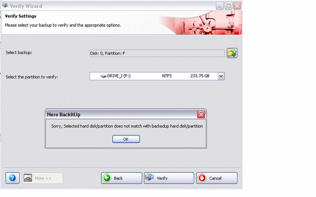

Postby CCampbell on Thu Jan 19, 2006 2:07 pm
Hi Ken,
When you use the 'Verify Backup' option you find under Wizards in BackItUP 2, what does it report about the backup?
Regards,
Craig

Postby KEN2 on Sun Jan 22, 2006 4:56 pm
Hi Craig,
Attached image shows the result of what you mentioned. I was using the same HDD from which I backed up data amd HDD was empty.
Thanks,

11:37:54 AM Nero BackItUp : 2.0.0.6
11:37:54 AM [Drive Restore Process]
11:37:54 AM Microsoft Windows XP
11:37:54 AM LOG creation date: 2006/01/29
11:37:54 AM The partition manager has been initialized successfully.
Source file: DriveRestoreDocBase.cpp, Line: 144
11:37:54 AM Drive restore process has been started.
Source file: DriveRestoreDocBase.cpp, Line: 287
11:37:54 AM Opening drive backup image file e:\bk_01_189.dat.
Source file: DriveImageRead.cpp, Line: 92
11:37:54 AM OLD version drive backup image file name is not in correct format!!!
Source file: DriveImageRead.cpp, Line: 498
11:37:54 AM Target drive / partition has been selected successfully.
Source file: DriveRestoreDocBase.cpp, Line: 227
11:37:54 AM Fit to target is selected: No
11:37:54 AM Master boot record will be restored: No
11:37:54 AM Target drive / partition information!!!
11:37:54 AM Disk number: 1, Partition number: 0, Drive letter: F:, Drive label: DRIVE_I (F:)
11:37:54 AM Actual size: 250986161664, Compress size: 75295848, Sectors: 490207347, Start sector: 63, End sector: 490207410, Partition type: NTFS
11:37:54 AM Source drive / partition information!!!
11:37:54 AM Disk number: 0, Partition number: 0, Drive letter: F, Drive label:
11:37:54 AM Actual size: 250986161664, Compress size: 250986161664, Sectors: 490207347, Start sector: 16128, End sector: 490223475, Partition type: NTFS
11:37:54 AM Geometry of \\.\F:, Cylinders: 30515, MediaType: 12, TracksPerCylinder: 255, SectorsPerTrack: 63, BytesPerSector: 512, Heads: 0
Source file: DriveAccessNT.cpp, Line: 183
11:37:54 AM Opening drive F:.
Source file: DriveRestoreCompilation.cpp, Line: 179
11:37:54 AM Locking drive F:.
Source file: DriveRestoreCompilation.cpp, Line: 180
11:37:55 AM OLD drive backup image file name is not in correct format!!!
Source file: DriveImageRead.cpp, Line: 313
11:37:55 AM Restoring drive backup image file no -1.
Source file: DriveRestoreCompilation.cpp, Line: 362
11:40:10 AM Drive backup image file no -1 has been restored successfully.
Source file: DriveRestoreCompilation.cpp, Line: 386
11:40:10 AM Opening drive backup image file .
Source file: DriveRestoreCompilation.cpp, Line: 622
11:40:10 AM Header lost. Source: Valid, Header: Invalid, Extended: Invalid.
Source file: DriveRestoreCompilation.cpp, Line: 643
11:40:10 AM Opening drive backup image file e:\.
11:40:10 AM Open file/folder (e:\) for reading has been failed. System error: (3) The system cannot find the path specified.
Source file: LBWinFile.cpp, Line: 102
11:40:10 AM Nero BackItUp drive image e:\ does not exist.
Source file: DriveImageRead.cpp, Line: 212
11:40:10 AM -3: Error has been occurred!!!
Source file: DriveRestoreDocBase.cpp, Line: 565

Postby CCampbell on Mon May 22, 2006 6:56 pm
Hi KEN2,
I've just completed a restore of a Nero 6.6 backup using the latest Nero BackItUp version 2.2.1.1 that comes with Nero 7.2.0.3b, and it restored wihtout any problems.
One thing I noticed in the Postings, you have a screenshot showing a Drive Image restore, but the only way to restore a Partition backup is by booting to the first disc and following the DOS prompts for restore.
So if you use Nero 6.6 to do File Backups, then you can use Nero 7 to restore them. I've confirmed this in numerous testing today.
If you do a Drive Image backup, then the only way to restore it would be too boot to the first disc and use the DOS interface to do the restore. Nero 7 has nothing to do with this process, as it's all selfcontained on the backup discs.
Regards,
Craig

Postby CCampbell on Tue May 23, 2006 1:05 pm
Hi KEN2,
Ahh, I see. Well, it's been a while since I read this, so my memory is rocky.
And no, Nero 7 bootable recovery disc will not work with Nero 6.
But I did a test with Nero 6 as well, where I created two Drive Image backups from two different systems. Then I swapped the first disc of each backup and tried to use them to restore the others drive backup, and this did not work. So it's not just an issue of getting Nero 7 boot recovery disc to work with Nero 6. It's a case of each Nero 6 or Nero 6 Boot recovery disc will only work with their related recovery disc sets.
Regards,

Postby CCampbell on Mon Jun 12, 2006 3:57 pm
Hi Ken,
No, Nero 7 now boots to a Linux to do the Restore, instead of DOS as Nero 6 did.
And our Engineers were checking to see if your issue was similar to one reported by an OEM, as they sounded similar. So we were hoping this would be the case and the next release of Nero 6 would have resolved the issue. It did for the OEMs, but obviously not for you. :-?
And restoring with Windows, was only ever planned to be supported when you do File backups, not Partition Backups.
Sorry.
Regards,
Craig
CCampbell
Posts: 966
Location: Glendale, CA
