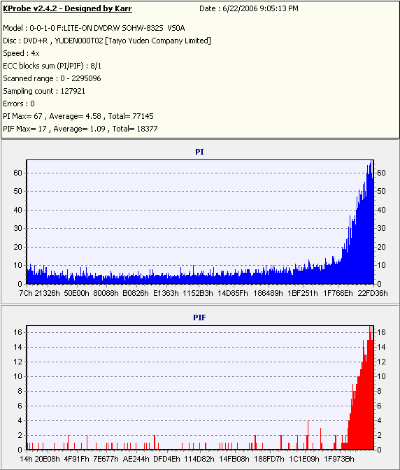

Postby dolphinius_rex on Fri Jun 23, 2006 12:31 am
Here's a Taiyo Yuden 8x DVD+R disc I burned in late September of 2004, and scanned in early October and then again tonight. These results scare me a lot :o
Postby [buck] on Fri Jun 23, 2006 12:35 am
Yeah, very scary. Myself, I've had RICOHJPNR01 go bad like that in only 6 months :o
Postby MediumRare on Fri Jun 23, 2006 12:46 am
OUCH! Is that one of the discs with bonding problems?
Postby dolphinius_rex on Fri Jun 23, 2006 1:32 am
MediumRare wrote:OUCH! Is that one of the discs with bonding problems?
I could test that... but then I wouldn't be able to document further degridation :(
Postby RJW on Fri Jun 23, 2006 3:40 am
You could check to see if there was initially some space.
Try to press the innerpolycarbonte circle slightly. You should be able to hear from the sound if there is space.
Not as good as the other methods but still it can help and is non destructive !

Postby [buck] on Fri Jun 23, 2006 10:55 am
dolphinius_rex wrote:My Nails aren't long enough right now to do that justice. I tried and I think there may have been some space, but it's hard to be 100% sure. Give me some time to grow some nails and check back with me :wink:
Couldn't you use something like a pen? Or maybe I'm not understanding this method correctly :-?
Postby RJW on Fri Jun 23, 2006 1:42 pm
No nails needed.
Just press polycarbonate and see if it squeeks.
nails means pulling means no additional measurements because exit disc.
Postby dolphinius_rex on Sun Jun 25, 2006 2:55 pm
I didn't hear any squeaking...
