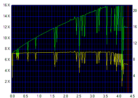

Postby cougar618 on Wed Aug 01, 2007 11:30 am
I have been using 1 media initally, dynex. It's a store brand from bestbuy. I've honestly have never had problems with it reaching and maintaining 16x before until now. i'm including a pic that will hopefully clear things up.

Postby Ian on Wed Aug 01, 2007 1:46 pm
The jagged graph and drop off suggest to me that this could also be a throughput issue. Have you checked to see if DMA is enabled?

Postby cougar618 on Sat Aug 11, 2007 2:13 am
After a bit of testing, i believe this is a throughtput issue. Sometimes using CD-DVD speed, i can get it to reach and maintain 16x. I initially thought that there was high CPU usage but there wasn't. But when i burn actual DVDs, the DVD burner's buffer actually starts to have trouble keeping up around 13x before it slows down to 12x. The physical memory keeps up and is at 100% the whole time though.
DMA mode 2 is enabled on my burner, and DMA Mode 6 for my HDD. They are on 2 different cables.
