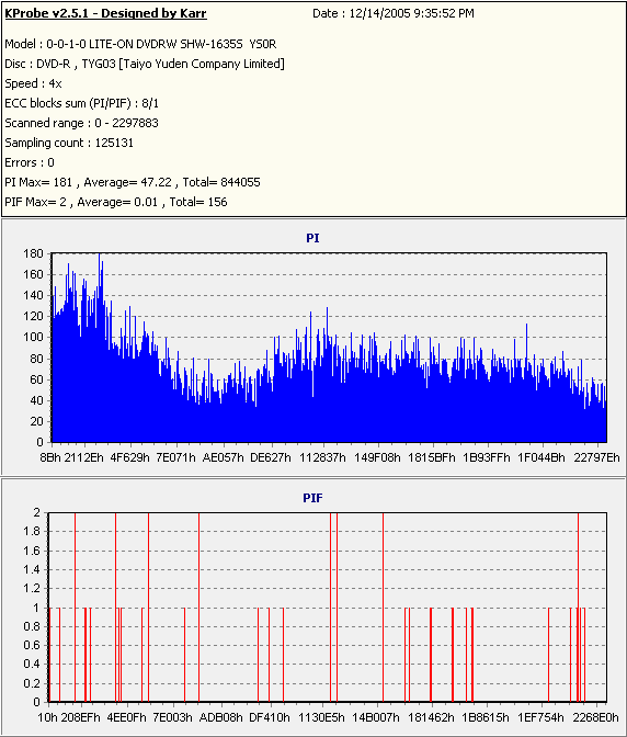

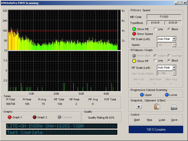

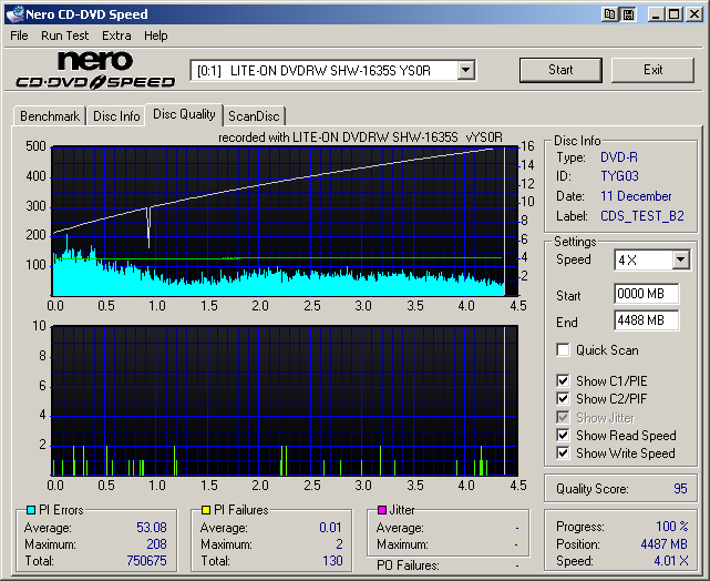

Postby dolphinius_rex on Tue Dec 13, 2005 10:54 am
NicW was kind enough to pass on a beta version of his attempt to fix the problem with DVDInfoPro. Here's some of the testing I've done with it, and comparison scans with other software.
As you can see from the pictures, all 3 scans are pretty similar.
I've done many comparison scans using all three pieces of software, and the following points have come out:
Nero CD Speed Range of variation:
Max PIE Reported: 156 to 208
Average PIE Reported: 43.21 to 57.53
K-Probe Range of Variation:
Max PIE Reported: 186 to 205
Average PIE Reported: 4.50 to 54.97
DVDInfoPro Range of Variation:
Max PIE Reported: 169 to 188
Average PIE Reported: 65 to 75
Have to run to work now, more comments later :wink:
DVDInfoPro Test, run with beta version of 4.51 with fix
K-Probe test, run with version 2.51
Nero CD/DVD Speed test, run with version 4.01

Based on the recorded variations of the maximum and average values, from all 3 pieces of software, I believe that you're going to get roughly the same results no matter which one you choose.... with a few exceptions:
Exception #1: K-Probe is calculating Averages REALLY weirdly... it's pretty obvious looking at the variations between averages. Out of 3 scans, to of them had averages under 10 (they were 4.x if I recall correctly). Not knowing exactly how the program is programmed, I'm not going to say this is "wrong", or "inaccurate"... especially considering that nature of the beast itself, but I *WILL* say it's different and unexpected.
Exception #2: The Total values of errors are quite different from all 3 pieces of software. K-Probe has the lead for total errors on the scan I posted, which would also lead credability to the liklihood that it tested more raw data then DVDInfoPro and CDSpeed. CDSpeed had the next highest volume of total PIE errors, and this was consistant when compared to DVDInfoPro. DVDInfoPro obviously had the least amount of total errors. Personally... I'd PREFER to have these totals all be roughly the same, or at least hear a reason as to why the differ so.
But other then those 2 exceptions, which I classify as minor, I'm pretty satisfied with the results.
What do other people think?

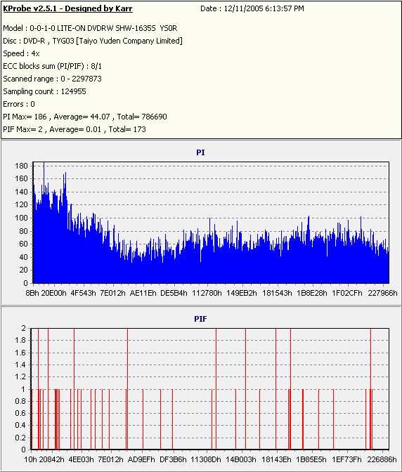

Here are some of my scans done in K-Probe
First Test with K-Probe
Second Test with K-Probe
Third Test with K-Probe
Postby dolphinius_rex on Sat Dec 17, 2005 4:49 pm
Here are the last 3 scans I did with K-Probe (there's some more in between this post and last post, but I think 6 scans should be sufficient)
Of these 6 posted scans the PIE total fluctuates from 786690 to 982169, that's roughly a 25% increase from lowest total to highest.
Of these 6 posted scans the PIF total fluctuates from 125 to 173, that's roughly a 40% increase from lowest total to highest. (In all fairness, the lowest test was a bit extreme for whatever reason. Removing the lowest total value changes the percentage difference to ~16%).
6th test I ran with K-Probe
7th Test I ran with K-Probe
8th test I ran with K-Probe
Postby MediumRare on Sat Dec 17, 2005 6:53 pm
I think the variation of those scans is pretty normal. This could be a thermal effect or something else. I've seen a variation in the PI total of up to a factor of 5 when doing repeated scans.
dolphinius_rex wrote:Exception #1: K-Probe is calculating Averages REALLY weirdly... it's pretty obvious looking at the variations between averages. Out of 3 scans, to of them had averages under 10 (they were 4.x if I recall correctly). Not knowing exactly how the program is programmed, I'm not going to say this is "wrong", or "inaccurate"... especially considering that nature of the beast itself, but I *WILL* say it's different and unexpected.
Thank you for sending me your scans. :D As a result, I'm able to clear up that mystery: the scans with the low average were the ones you did with PI at 1ECC. So the factor of 8 in the average is pretty well what you'd expect (if the total is comparable- see the "normal variation" above).
I still don't understand the difference in the number of samples (total/average) between KProbe and DIP (only 1/2 as many in DIP).
