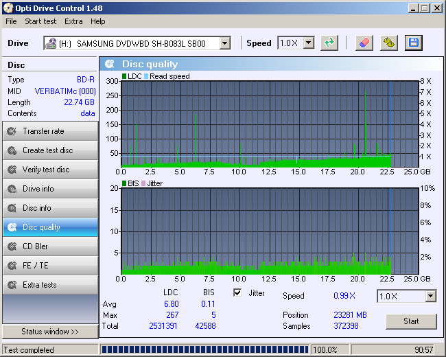

I'm using 25 GB BD-R to back up files so I want to get some media that I can have some confidence in (and yet is not too expensive). I am burning at 8x with the Pioneer BDR-205 (fw:1.03) and checking the quality (error scan) with Samsung SH-B083L (fw: SB00) using the Opti Drive Control 1.48 software to do LDC and BIS error scans.
So far I am satisfied with Verbatim 4x Inkjet-printable (media ID: VERBATIMc ), which the BDR-205 can burn at 8x with good results. I tried scanning one disc, holding 22.74 GB at 1x (90 minutes) and at 8x (17 minutes).
1x scan (22.74 GB):
LDC: 6.80 / 267 (avg / max)
BIS: 0.11 / 5
8x scan (22.74 GB):
LDC: 11.70 / 185
BIS: 0.21 / 8

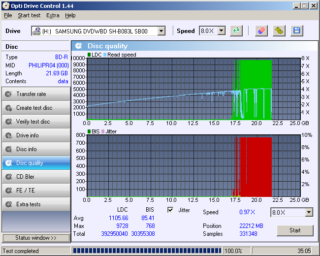

According to c't magazine http://www.heise.de/ct/ for a quality BD-R burn, the average LDC should stay below 13 and the maximum BIS should not exceed 8, so these results qualify as good. I also tried "VINPOWER DIGITAL" media (media ID: PHILIPR04 ) which still reads back without failures, but did not do nearly so well in the error scan, even when burned at 2x which is pretty slow. A huge error rate after the 17 GB mark resulted in:
LDC: 1105.66 / 9728
BIS: 85.41 / 768
VERBATIMc : good scan
PHILIPR04 : bad scan

I have only done about 10 scans so far. I have no idea how the hardware & software really work internally, but the SH-B083L does seem to be measuring *something* which is consistent. When I scan the same disk again, I get roughly the same results. When I scan the Verbatim discs, they are almost always good in the sense of avg. LDC < 13 and max. BIS < 9 and the Vinpower / Optical Quantum discs are always awful after about the 17 GB point, so there is some problem there. (I just noticed there is a 1.08 firmware update for my burner, maybe that would help the burn quality).
> if those results were truly that bad, the disc shouldn't have been readable.
That may be true, but I suspect the OptiDrive software may be putting the drive into a different mode which is more sensitive to errors, when doing the error scan. When I put one of these "bad" disks in the same drive and do a speed test, the speed only drops to about 6x in the bad portion of the disc. Whereas, during the scan on the same disc, the speed frequently drops to 0.1x so it seems there is something different going on. All I can say is it seems to be measuring some real property of the disc, because each disc always measures about the same.
