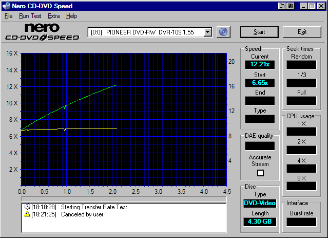

Hey Ian, ltns. I've used Nero CD-DVD Speed that came with some Nero version 6.
Since my post, I've downgraded to FW 1.4 as per some posts I've read on other forums and I've just run CDSpeed now with the following output (stopped it early since it's clear it's not ripping at 12x):
The disc isn't scratched up at all, either. I got the drive OEM from Newegg.
Riplocked A09

On another note, I just loaded the old firmware version 1.05 on a whim and then reloaded the 1.55 firmware and now all is working.
Unlocked A09.
