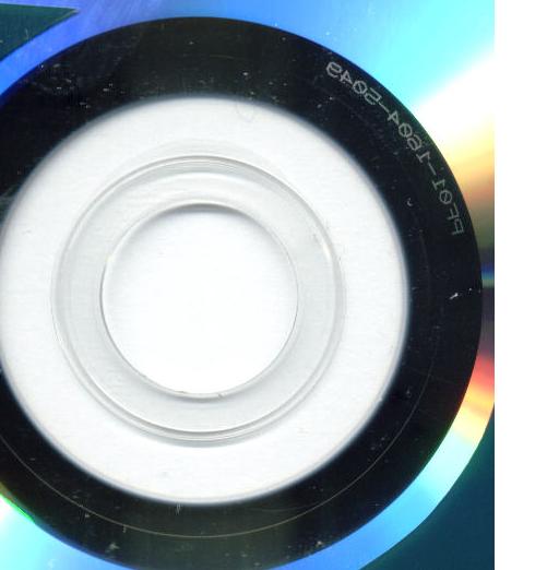

Now I look at some media to find out who manufacture Fujifilm03.
Here are 3 pics. The serial on the Philips-branded Fujifilm03 looks more like the serial at the Platinum Ritek G05, not like the Fuji ProdiscF01.
Now I read somewhere that newer Fujifilm03 are made in India, so it´s from MBIL.
And the same for Ricohjpn02, older batches made in Taiwan from Ritek, newer are from India
Fuji ProdiscF01
Fuji ProdiscF01.JPG (24.73 KiB) Viewed 3321 times
Fujifilm03
Philips Fujifilm03.JPG (15.05 KiB) Viewed 3322 times
Platinum Ritek G05
Platinum Ritek G05.JPG (33.72 KiB) Viewed 3324 times
Postby RJW on Wed Oct 19, 2005 4:18 pm
This Philips FUJIFILM03 is made by Ritek usseing FUJI Dye and specifications.
However incase of PHilips also a made by MBIL version exists.
How is the quality of the Philips disc compared to the Prodisc(FUJI) manufactured disc ?
So far the results I've seen suggest that RItek version is a bit better.
Ricoh 8x +Rmedia can be MBIL& Ritek currently.16x +R only Ritek makes them at this time. Dual layer Ricoh is a ritek exclusive (at least for some months still.). All ricoh -R media is made by CMC with CMC codes.

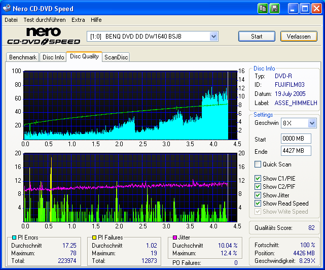

My Benq 1640 did a bit better with F01, but overall poor performance from Benq.
Saw much better results for Fujifilm03 and F01, especially from the old LG 4163 :
http://www.cdfreaks.com/article/191/6
Overall, I´m not impressed with the DVD-R-performance from Benq 1640, when not using highest quality TY or MCC
Fuji DVD-R 8x
Benq 1640 BSIB
381 Fuji DVD-R 8x Zwei Asse Benq 1640 BSIB.png (54.87 KiB) Viewed 3284 times
Philips DVD-R 8x
Benq 1640 BSJB
Philips DVD-R 8x Olli Zwei Asse Benq 1640 BSJB.png (57.85 KiB) Viewed 3303 times
Postby RJW on Thu Oct 20, 2005 4:37 am
Is that a Ritek or a MBIL FUJIFILM03. It should be one of these 2 seeing it is Philips but that's it.
Postby Gabe on Thu Oct 20, 2005 7:35 am
RJW wrote:Is that a Ritek or a MBIL FUJIFILM03. It should be one of these 2 seeing it is Philips but that's it.
Made in Taiwan, must be Ritek
