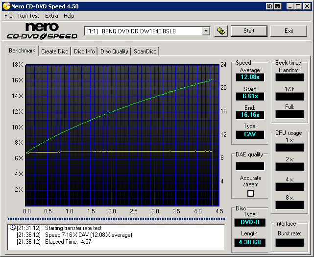

Who needs an 18x DVD writer. This thing is smoking fast when writing to DVD+R and DVD-R media. My only real beef is the high jitter rate in the beginning. Hopefully LG can fix this in the next firmware update.
LG GSA-H10N CD Speed DVD-R Write Quality.jpg (105.37 KiB) Viewed 10358 times
LG GSA-H10N CD Speed DVD-R Write.jpg (98.33 KiB) Viewed 10343 times

You know, that jitter is so rediculously high that even what are usually unpicky players will start having troubles. It almost makes LiteON look good.
I'd have a hard time recommending this drive without seeing this jitter problem fixed.
