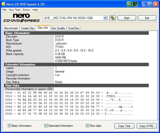

I got a few samples of Memorex's new Pro Gold archival DVD-R media. The media uses a TDK MID (TTH01). Manufactured by MAM-E?
Sorry dolph.. I only have a few of these. When I get more I'll send you some.
