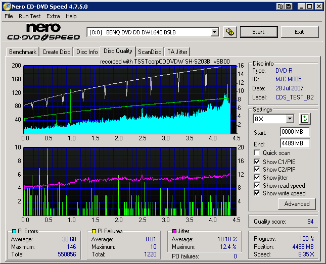

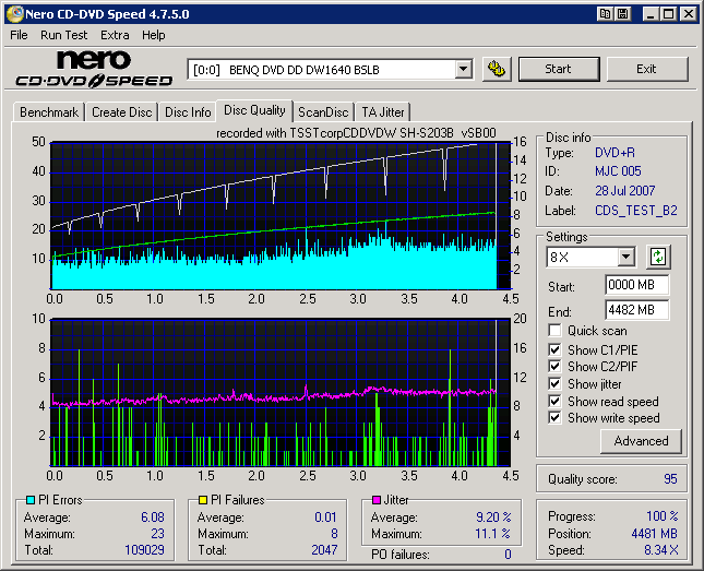

Next is the Samsung SH-S203B with the SB00 firmware. Here too, the drive wrote to them at 16x. In both cases, the writing quality was pretty good.
Samsung SH-S203B CD Speed Write Quality DVD+R.png (22.15 KiB) Viewed 489 times
Samsung SH-S203B CD Speed Write Quality DVD-R.png (22.36 KiB) Viewed 476 times
