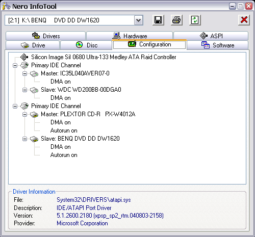

Postby dodecahedron on Thu May 26, 2005 6:08 am
why does my motherboard have 2 Primary IDE channels ???
screenshot of Nero's InfoTool showing 2 Primary IDE channels
Postby dburg on Thu May 26, 2005 1:55 pm
Couldn't it be an optimization from the RAID implementation of the board? (Just guessing/asking)

Postby dodecahedron on Thu May 26, 2005 4:08 pm
dunno.
the motherboard (Asus A7N8X-Deluxe) has a Silicone Image Sil 3112A SATA Controller and supports RAID 0/1. but currently i have the SATA disabled (jumper on the motherboard).
i also have a Siig PCI ATA RAID card (combo card actually). the controller is seen in the screenshot. but no drives attached to it right now.
Postby ItalianJob on Thu May 26, 2005 4:26 pm
Did you use NeroInfoTool 3.01 from cdspeed2000.com ?
Did you check in Configuration Panel/System/Peripherals bla bla... if there are
- 2 IDE Primary
or - one Primary one Secondary.
If there are 2 IDE Primary, try to uninstall the bad one and restart Windows.

Postby dodecahedron on Thu May 26, 2005 7:37 pm
yes, InfoTool 3.01
Device Manager reports Primary and Secondary IDE Channels.
i should re-enable SATA with the jumper on the motherboard see if it makes a difference.
Postby ItalianJob on Fri May 27, 2005 10:45 am
Maybe you can try to delete Nero CD-DVD Speed registry keys and try again ? HKLM/Software/ahead/Nero Toolkit/CD Speed
Or maybe an ASPI/SPTI/patin couffin weird problem (compatibility issue with such a driver). Dunno... ?

Postby CCampbell on Fri Jun 03, 2005 1:50 pm
Does it also report two Secondary IDE Channels?
I would suspect that you do have two Primary and Secondary IDE Channels. A number of boards these days do have this.

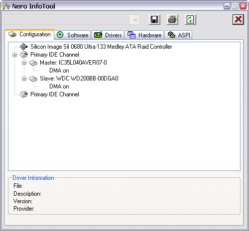

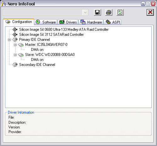

Postby dodecahedron on Mon Jul 04, 2005 4:50 am
no.
the board has one ATA controller that has one Primary and one Secondary IDE channels.
for some reason disabling the on-board SATA RAID controller did that.
here are two InfoTool screenshots. two HDs on the Primary IDE channel of the motherboard's ATA controller.
since the only difference to the system between taking these 2 screenshots is changing the SATA_en jumper on the motehrboard, i'm sure that has something to do with this weird thing.
i'm not sure it's a bug in InfoTool. possibly a bug in the BIOS ?
motherboard's on-board SATA RAID controller disabled by a jumper
InfoTool 3.PNG (22.35 KiB) Viewed 1466 times
motherboard's on-board SATA RAID controller enabled
InfoTool 4.PNG (23.01 KiB) Viewed 1466 times
