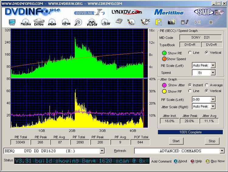

Postby KenW on Thu Oct 14, 2004 9:37 pm
As promised NicW has again made more changes to the 1620 scanning at high speed this scan is on DVDinfopro 3.31 beta as you see the speed has been corrected and also the data displays, note this media was burned on a liteon 1633 and scanned on benQ 1620 with the high speed scan enabled fw.
