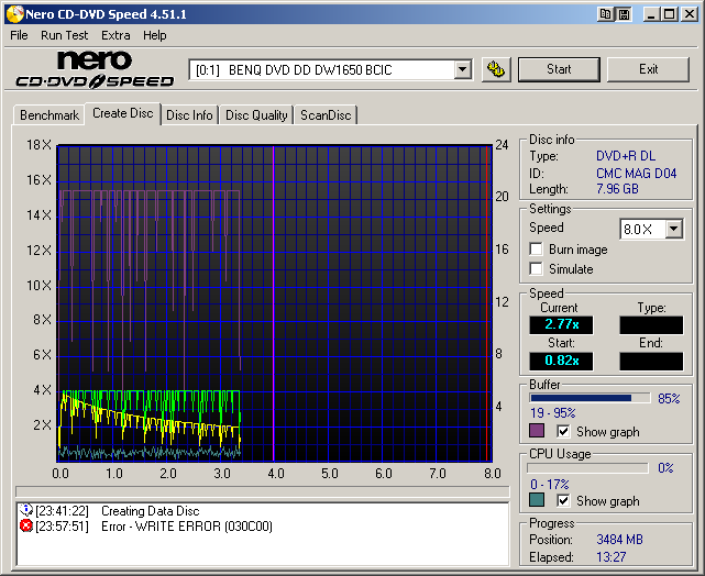

I picked up a 25pc spindle of these for $30 CAD today at Futureshop today, and so far they've failed during the burn process (before the layer break) on my BenQ DW1640 and BenQ DW1650, both of which officially have 8x support for this media (but burned it at 4x only!). I've almost completed a burn on one of the discs at 2.4x in my Pioneer DVR-111D running firmware 1.29 though.
So far, I'm VERY disappointed...

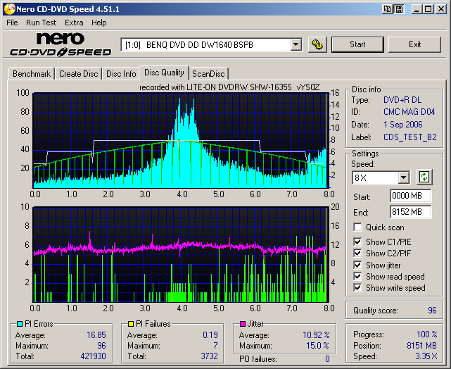

Here are some scan results of this media, from the drives that I could get to actually burn it (and some variations).
As you can see, not too impressive, but at least readable all the way through (when you don't enable hypertuning!)
Burned on the LiteON SHW-1635S at 8x (YS0Z)
Burned on the LiteON SHW-1635S at 8x (With Hyper Tuning Enabled) (YS0Z)
Burned on the LiteON SHW-1635S at 4x (YS0Z)
