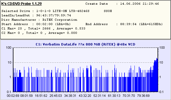

I think I'll go with the Verbatim discs, mainly because they have a white/silver surface. I rescanned one disc I burned 19 months ago and it hasn't changed at all. I bought samples of TDK in 2 stores and a couple more Verbatim (Made in China) and they perform similarly (not quite as good as the older Verbatim)- see KProbe scans. With both media types, one disc had C1_ave ca. 1.5 and the other ca. 0.5. Strangely, the true burning speed was 32x- independent of the chosen speed (32x or 40x).
I also tried another one of my SKC's (had to turn Smartburn off to burn faster than 16x) and it's the best of the lot- but unfortunately I can't get them any more.
The better of the 2 TDK discs. Chosen speed: 40x, effective 32x.
The better of the 2 new Verbatim discs. Burned @32x.
This is a Video-CD I burned 19 months ago. Scan @max is 32x. C1 is virtually unchanged from first scan.

The scans make me wonder is the 52327S much more picky.
At what speed are these measured. Because most cases setting above 24x means C2 errors on my drive.
Also a CDA-3000 showed also that above 24x things went down hill except for the TDK.
So I wonder was I very unlucky with all my other 90 minutes media or is the 48246S much more forgiving or was it measured at lower speed.
Postby MediumRare on Fri Jun 23, 2006 3:44 pm
I always scan my CD's at maximum. For these 90 min discs, the speed even goes above 52x at the end.
I love my LTR-48246S! :D It's never let me down. All audio CD's I've burned with it (even some marginal media with C2's in the scans) have played in any CD-player I've tried them in. It's also a better audio ripper (with EAC) than either of my DVD-burners, so maybe it's a better reader than your 52327S.
