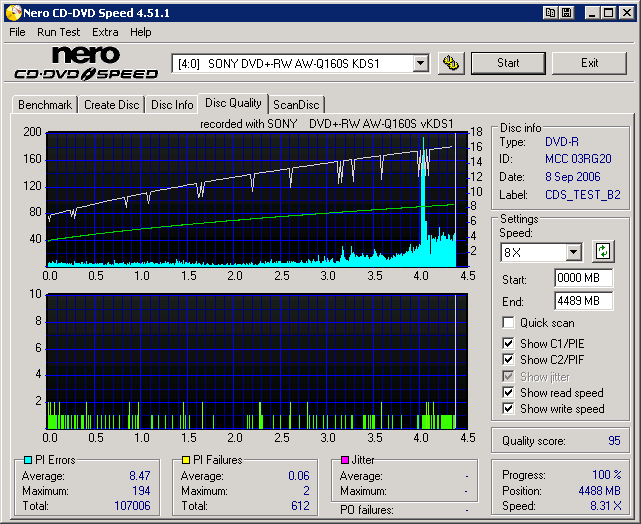

Postby Ian on Sat Sep 09, 2006 1:52 pm
I ran a quick test with some Verbatim 16x DVD-R media.
Sony AW-Q160S CD Speed DVD-R Write Verb 2.png (19.73 KiB) Viewed 16997 times
Sony AW-Q160S KProbe Verb DVD-R.PNG (10.79 KiB) Viewed 16963 times
Sony AW-Q160S Read Verb DVD-R.png (16.42 KiB) Viewed 16942 times
Sony AW-Q160S BenQ Verb DVD-R.png (21.13 KiB) Viewed 16943 times
Postby Ian on Sat Sep 09, 2006 2:01 pm
To answer some of your questions..
The drive writes to DVD+R DL media at 8x. However, it requires media rated at that speed. With Verbatim's 2.4x DL media, the speed was limited to 4x.
The drive recognized DVD-R DL media without any problems. I have not done any test burns yet though.
The drive seems to work alright with KProbe. I did have to switch the driver to SPTI or whatever before it would recognize the drive.
With CD Speed, the number of PI Failures seems abnormally low. It makes me think its not calculating them correctly or its using Sum1.
Keep the questions coming.. I'll probably move this thread over to the non-subscriber part of the forum in the next day or two.
Sony AW-Q160S KProbe.PNG (11.12 KiB) Viewed 16920 times
Sony AW-Q160S CD Speed Write Quality.png (19.64 KiB) Viewed 16901 times
Postby MediumRare on Sat Sep 09, 2006 6:03 pm
Ian wrote:The drive seems to work alright with KProbe.
Looks like it's a MediaTek chipset then...
Ian wrote:With CD Speed, the number of PI Failures seems abnormally low. It makes me think its not calculating them correctly or its using Sum1.
Do you mean the maximum value for PIF? CDSpeed does use Sum1 for PIF on LiteOn drives. Normally, the results from CDSpeed and KProbe are essentially identical (except for some idiosyncracies in averages). Since your scans are at different speeds, the totals aren't exactly comparable though.
Postby Ian on Sat Sep 09, 2006 6:43 pm
MediumRare wrote:Do you mean the maximum value for PIF? CDSpeed does use Sum1 for PIF on LiteOn drives. Normally, the results from CDSpeed and KProbe are essentially identical (except for some idiosyncracies in averages). Since your scans are at different speeds, the totals aren't exactly comparable though.
Yeah, you're right. I don't use it with my Lite-On drives.
If I remember right, both use the same API's to gather the data from the drive.

Taiyo Yuden 16x DVD-R - TYG03 @ 16x
Postby aviationwiz on Wed Sep 27, 2006 6:46 pm
PlexTools Pro XL Scans
Taiyo Yuden 8x DVD+R - YUDEN000 T02 @ 8x
Postby aviationwiz on Wed Sep 27, 2006 6:49 pm
Optodisc - Acro Circle 16x DVD+R @ 6x
Postby aviationwiz on Wed Sep 27, 2006 6:55 pm
The top speed offered was 6x.
Optodisc - Acro Circle 16x DVD-R @ 8x
Postby aviationwiz on Wed Sep 27, 2006 7:01 pm
