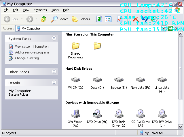

recently i've started having this strange problem.
whenever i reboot the drive letters of the optical drives get reassigned differently than they're supposed to be.
my drives:
Motherboard IDE controller, secondary channel:
master LG DVDRAM, slave Lite-On CDRW
IDE controller card, secondary channel:
master BenQ DVDRW, slave Toshiba DVDROM
Code: Select all
=== Scsi-Device-Map ===
CdRomPeripheral: BENQ    DVD DD DW1620   B7W9   Pnp680r Port 0 ID 0  DMA: Off
CdRomPeripheral: TOSHIBA DVD-ROM SD-M1712J004   Pnp680r Port 0 ID 1  DMA: Off
DiskPeripheral : ST380817AS              3.42   Si3112r Port 1 ID 0  DMA: Off
DiskPeripheral : IC35L040AVER07-0                 atapi Port 2 ID 0  DMA: On
DiskPeripheral : WDC WD200BB-00DGA0               atapi Port 2 ID 1  DMA: On
CdRomPeripheral: HL-DT-ST DVDRAM GSA-H10L         atapi Port 3 ID 0  DMA: On
CdRomPeripheral: LITE-ON LTR-52327S               atapi Port 3 ID 1  DMA: On
=== CDRom-Device-Map ===
HL-DT-ST DVDRAM GSA-H10L   J:   CDRom2
LITE-ON LTR-52327S         K:   CDRom3
BENQ DVD DD DW1620         L:   CDRom0
TOSHIBA DVD-ROM SD-M1712   M:   CDRom1
the usual arrangement i have is:
Code: Select all
HL-DT-ST DVDRAM (motherboard, secondary master): J
LITE-ON CDRW    (motherboard, secondary slave):  K
BENQ DVDRW      (IDE card, secondary master):    L
TOSHIBA DVD-ROM (IDE card, secondary slave):     M
after rebooting i get:
Code: Select all
HL-DT-ST DVDRAM (motherboard, secondary master): I
LITE-ON CDRW    (motherboard, secondary slave):  J
TOSHIBA DVD-ROM (IDE card, secondary slave):     H
drive letters C-G are used by HD partitions.
see the pics below.
i didn't install any new software recently (not that i can think of any software that would do that), just ZoneAlarm but i think the drive-letter-changing started later that that.
no recent BIOS update or firmware updates of the drives.
note the weird order of letters i get. makes sense that it starts with H since up to G are used. but why skip K? and why this order?
any idea why this is happenning ???
MyComputer - normal drive letters.png (49.21 KiB) Viewed 5934 times
MyComputer - messed up drive letters.png (49.28 KiB) Viewed 5924 times

Postby dodecahedron on Mon Aug 07, 2006 3:10 am
bump?
anyone have a clue ?
i have DaemonTools installed, but:
1. i had it installed for a long time now and this phenomenon just stared happening a short while ago.
2. i only haev DT running when i actually need it (when i mount images).
when i'm done i set number of drives to 0 (disable) and exit the program (so it doesn't run in the background).
can't think of anything else.

Postby dodecahedron on Tue Aug 08, 2006 2:01 am
hi pranav, nice to see you again.
but you didn't understand:
i did fix the drive letter mis-assignments in Computer Management.
but after a reboot - messed up again!
fixed again, reboot, messed up again. etc. etc.
always messed up the same way described above.
Postby pranav81 on Tue Aug 08, 2006 2:21 am
Yeah...its been a long time since I actively participated.Just completed my professional education and now clearing up things to start a new life......
How exactly do you change the drive letters in there?
::Pranav::
Increasingly mathematics will demand the courage to face its implications.
pranav81
Posts: 1160
Joined: Thu Dec 05, 2002 6:57 am
Location: Sunnyvale, CA
Postby dodecahedron on Tue Aug 08, 2006 9:33 am
pranav81 wrote:Yeah...its been a long time since I actively participated.Just completed my professional education and now clearing up things to start a new life......
congrats
pranav81 wrote:How exactly do you change the drive letters in there?
is there more than 1 way ???
in the Disk Management applet: right click the drive, choose Change drive letters and paths, click the Change button, select the new letter i want (the way it was before getting "messed up"), then click OK.
totally straightforward.
the problem isn't with how i'm changing the drive letters. they get changed just fine.
the problem is what happens when i reboot.

Postby dodecahedron on Sat Aug 12, 2006 5:18 pm
shit!
i decided to give up.
since the last drive letter taken by an HD is G, i decided to reassign the opticals to H,I,J,K.
the new arrangement is:
Code: Select all
HL-DT-ST DVDRAM (motherboard, secondary master): H
LITE-ON CDRW    (motherboard, secondary slave):  I
BENQ DVDRW      (IDE card, secondary master):    J
TOSHIBA DVD-ROM (IDE card, secondary slave):     K
Code: Select all
see the pics below.
for some reason the BenQ is unchanged, both in the previous letter assignments (1st post) and in the new setup (this post).
but the order of reassignment isn't the same now as it was before :o
it turns out that the fact that i had a few "unused" letters between HDs and opticals isn't the reason.
MyComputer - normal drive letters 2.png (49.53 KiB) Viewed 5804 times
MyComputer - messed up drive letters 2.png (49.55 KiB) Viewed 5801 times
