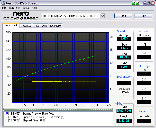

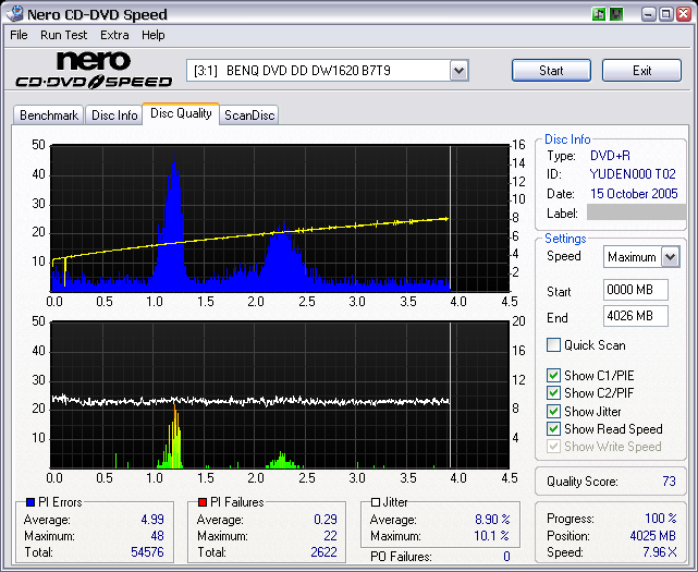

burned a backup of a movie with my BenQ DW1620 B7T9 onto TDK 8x DVD+R TY T02.
i checked the transfer rate on the Toshiba DVD-ROM (see below) and was alarmed. but when i did a transfer rate at 12x and 8x, both on the Toshiba and on the BenQ, the curve was smooth and nice. see pics below, also Disc Quality.
CDSpeed tranfer rate test on the Toshiba DVD-ROM @ 12x.
perfect.
transfer rate on toshiba at 12x.png (48.29 KiB) Viewed 37807 times

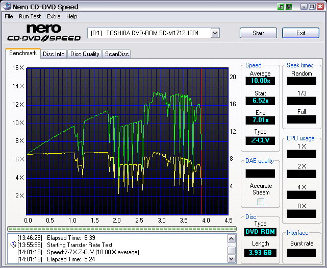

CDSpeed tranfer rate test on the Toshiba DVD-ROM @ 16x.
note how the dips correleate with the quality scan above.
transfer rate on toshiba at 16x.png (53.39 KiB) Viewed 37813 times
CDSpeed Disc Quality test on the BenQ burner.
quality test on benq.png (54.12 KiB) Viewed 37808 times

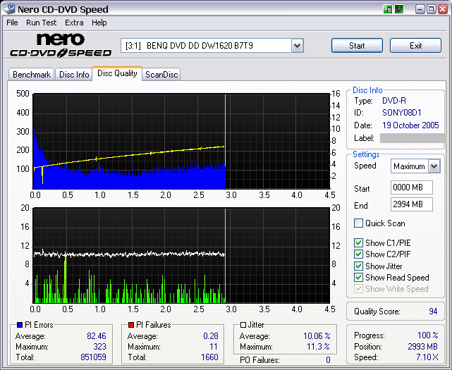

Postby dodecahedron on Thu Oct 20, 2005 5:50 am
and here's another one:
Sony 8x DVD-R SONY08D1 burned at 8x.
transfer rate tests at 12x and 16x very ugly!
i really don't know what to make of it
the Toshiba is picky on a variety of media when reading at high speeds (> 8x) ???
do you know of other media that reads (or doesn't) well at < 8x on this drive?
does it mean these burns are'nt good? or should i disregard transfer rate tests on the Toshiba at > 8x as an indicator of a good/bad burn?
disc quality test on BenQ DW1620
Sony-1 burned8 discquality benq.png (54.88 KiB) Viewed 37680 times
