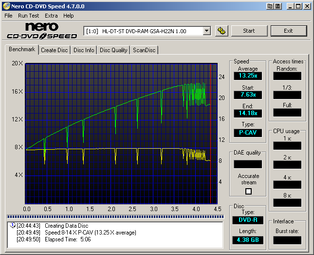

I've been testing the GSA-H22N and its performed as expected, except when writing at 18x. The writing times are impressive, but not as low as they should be. Looking at the screenshot below, you can see why. When it reaches the 3.7GB mark, the transfer rate starts to jump up and down and doesn't quite reach 18x.

Ok, i had a h22n drive and it showed the same behaviour, it came with firmware version 1.00 and was udma 4 but whenever i burned mcc004 the device buffer would just go crazy towards the end of the disc even though the program buffer was perfectly full. However it would not happen when you burned "create data disc" using cdspeed. However if you used cpspeed or imagburn to write actual image to the disc then it would happen, even though the program buffer was full. This behaviour was also noticed on one of my newer liteon LH-18A1P drives, the other was perfectly fine and actually wrote with better quality. This behaviour i think happens because the wopc is too aggressive for some perticular drives. I think it's the drives that have not been caliberated or fine tuned to spec and when they write data to the disc, at high speeds the wopc algorithm just goes crazy and device buffer undderruns start happening.

That's a good point Sonny. In theory then, it shouldn't do this when simulating with DVD-R media.
