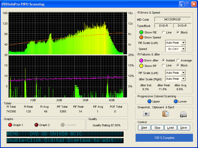

I picked up a spindle of the above for testing, and have found strange results. Utter garbage. The only visible difference between them and 50 or 100 disc spindles is near the hub(all non-printable). Instead of the clear section between the silver matte and the hub, on the 25's it's a reflective surface. I've tried them on several of my burners, all with poor results. Anyone know the story on these "reflective hub" discs, or had similar results?

Serial # from bottom of disc:ZD3177-DVR-J47C1
Burned with Pioneer 111 1.29, BenQ 1655 BCIB, LG GSA-H22N 1.0.
Symptoms see attached scans, the scans below with above 80% will at least play in a stand alone DVD player, but they don't play them well ie skipping, pixelating. Checked on a Denon 2200, HK DVD-25 and a LG 530. Burned at 8, 12, 16 & 18X, similar results on them all.
8X BenQ 1655
verb mcc03rg20 25disc spindle 85per discory.png (54.52 KiB) Viewed 8564 times

Postby [buck] on Sun Oct 01, 2006 10:17 pm
Yep, that is definately pretty nasty. I would return them or get them replaced. Could you give us the clear stamped serial at the very inner part of the hub?
Postby dolphinius_rex on Mon Oct 02, 2006 1:41 am
Yeah, that's a very seriously screwed up spindle!! And like [buck] requested, can we possibly get the other serial on the disc (not the ZD one you already gave). It will let us know if the discs are manufactured by Prodisc or CMC.

Postby [buck] on Mon Oct 02, 2006 7:38 pm
That's a Prodisc serial alright. It's not that surprising, really, because everything I've seen suggests Prodisc MCC has a signifigantly higher failure rate than CMC MCC. :x
To answer your question, Prodisc serials are primarily numeric, and they have a "+" or "-" to signify whether the disc is a DVD+R or DVD-R.
