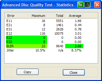

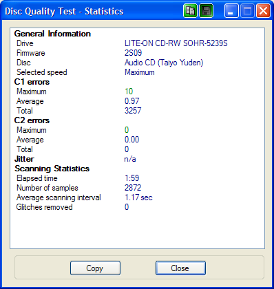

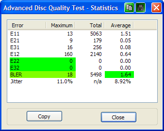

OK guys, I'm just going to post the results from the 55 minute music CD-R ran with CD-DVD Speed 4.7.0.0 on Taiyo Yuden CD-Rs burned at 16X for each drive. All tests run on BenQ drive. The drives will be listed in order (BenQ DW1655, Lite-On LTR-52246S, Lite-On LDW-851S) and for each drive the Advanced Disc Quality stats will be listed first followed by the Disc Quality stats..........actually all Advanced stats will be listed first followed by all Disc Quality stats (that's better for comparing in this thread. I hope this works.
First, the run in the updated version of CD-DVD Speed revealed different general quality percentages:
BenQ DW1655 - 97%
Lite-On LTR-52246S - 97%
Lite-On LDW-851S - 93%
BenQ DW1655 Advanced Disc Quality Statistics(...17_24-stats.png)
Lite-On LTR-52246S Advanced Disc Quality Statistics(...18_22-stats.png)
Lite-On LDW-851S Advanced Disc Quality Statistics(...19_09-stats.png)
BenQ DW1655 Disc Quality Statistics(...16_58-stats.png)
Lite-On LTR-52246S Disc Quality Statistics(...18_00-stats.png)
Lite-On LDW-851S Disc Quality Statistics(...18_53-stats.png)
OK, so I didn't post it exactly right, but the order is there. A description is now included now that I figured out how to post comments. :) What do you guys think? I'm thinking I should just leave my BenQ drive in there for now.
Disc burned with BenQ DW1655
Disc burned with Lite-On LTR-52246S
Disc burned with Lite-On LDW-851S

Postby bicomputational on Thu Jan 04, 2007 8:33 am
The combination of the higher c1 totals and the quite high
jitter of the 851s would really make me hesitate to use the
drive, even if the numbers are technically within spec.
It's like a baseball player just before he has that year where
he can't hit the fastball anymore - you can see the skills are
going.

Postby SkaarjMaster on Thu Jan 04, 2007 9:33 am
Makes me wonder what it was doing when I first got it almost 3 years ago and what kind of DVD burns it made? Anyway, I'll keep the CD-R burns it made until the music starts sounding crappy or the disc needs reburning. In the meantime, looks like I'll keep the BenQ for DVD and CD burns. It's nice to know that I can burn CD-Rs with the other computer (52246S) whenever I want to though.
I ran the same tests at work on those 3 discs, but the Advanced Disc Quality tab did not appear (maybe because the test drive is CD only?). Only ran the disc quality tests and it looks like the quality scores improved to 99%, 99% and 97%. Here are the statistics posted in order (BenQ, 52246S and 851S):
