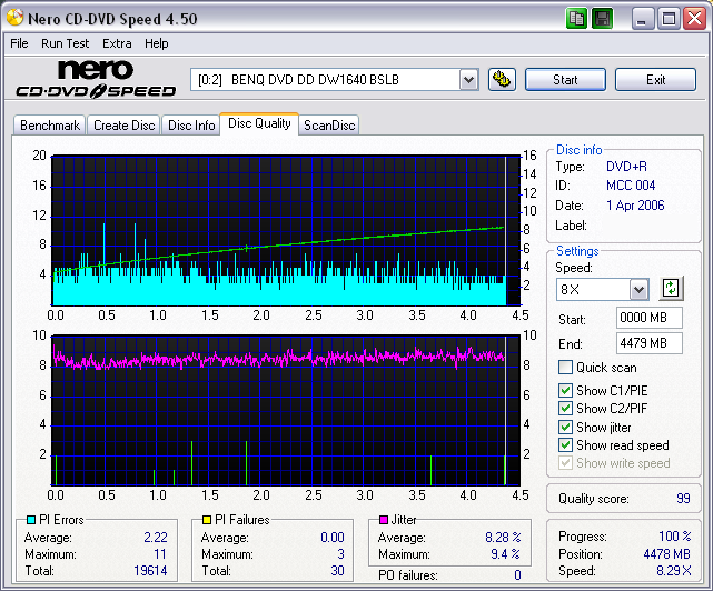

Postby [buck] on Sun Apr 02, 2006 10:14 pm
Verbatim DVD+R 16X (made in Taiwan by CMC Magnetics) - 25pk spindle
MCC004
Burned with:
BenQ DW1640 OEM (made in China)
Firmware: BSLB
SolidBurn ON
WOPC OFF
Burned at 12X
verbatim_mcc004_scangraph_12X_solidburnon_wopcoff_benqdw1640bslb_april02.06(2)(2).PNG
verbatim_mcc004_scangraph_12X_solidburnon_wopcoff_benqdw1640bslb_april02.06(2)(2).PNG (57.38 KiB) Viewed 22920 times
verbatim_mcc004_burngraph_12X_solidburnon_wopcoff_benqdw1640bslb_april02.06(2)(2).PNG
verbatim_mcc004_burngraph_12X_solidburnon_wopcoff_benqdw1640bslb_april02.06(2)(2).PNG (55.04 KiB) Viewed 22922 times
