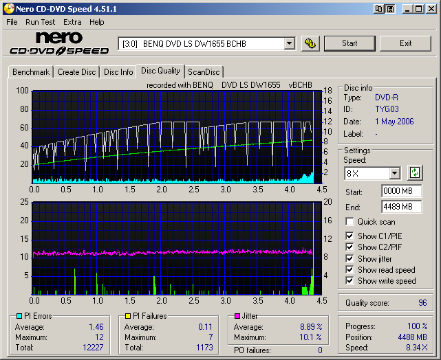

Postby Ian on Tue Mar 28, 2006 8:04 pm
Memorex Pro Gold 8x DVD-R Media
Written and tested with BenQ DW1655 (BCDB).
Memorex Pro Gold DVD-R Quality.jpeg (85.68 KiB) Viewed 10793 times
Memorex Pro Gold DVD-R Transfer.jpeg (77.4 KiB) Viewed 10790 times

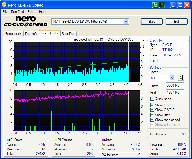

Postby [buck] on Thu Apr 27, 2006 4:59 pm
TDK DVD-R 16X (made in Luxembourg) - 25pk spindle from Costco
TTH02
Burned with:
BenQ DW1665 Retail (made in China)
Firmware: BCAB
SolidBurn OFF
WOPC ON
Burned at 12X
1655 latest BCHB firmware

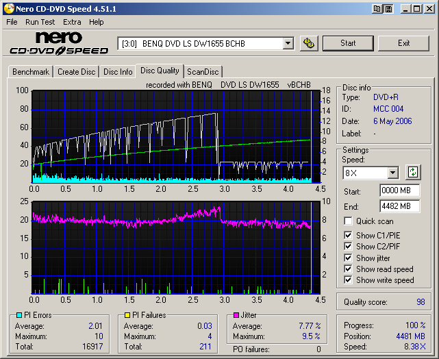

Postby Dartman on Mon May 08, 2006 8:29 pm
Here's a disk that was going fine and then speed dropped back to 4x
BenQ DW1655 OEM I/O Magic crossed(made in China)
Firmware: BCHB
SolidBurn ON
WOPC ON
Overspeed ON
speed 16x attempt
Verbatim MCC004 16x attempt at 16x made in Taiwan media

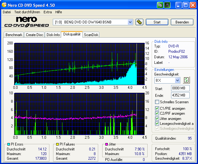

Postby Gabe on Sat Jun 03, 2006 3:27 pm

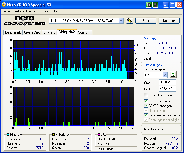

Burner: Benq DW 1655 BCGB
Media-brand: Datawrite DVD+R 4x
Media-code: RICOHJPN R01
Write-speed: 4x
Datawrite Classic DVD+R 4x Benq 1655 BCGB B.PNG (56.45 KiB) Viewed 10430 times
Datawrite Grey DVD-R 16x 1655 BCHB B.png (57.02 KiB) Viewed 10402 times
Datawrite Grey DVD-R 16x 1655 BCHB L.png (54.94 KiB) Viewed 10401 times

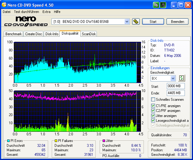

Postby Gabe on Sat Jun 03, 2006 4:13 pm

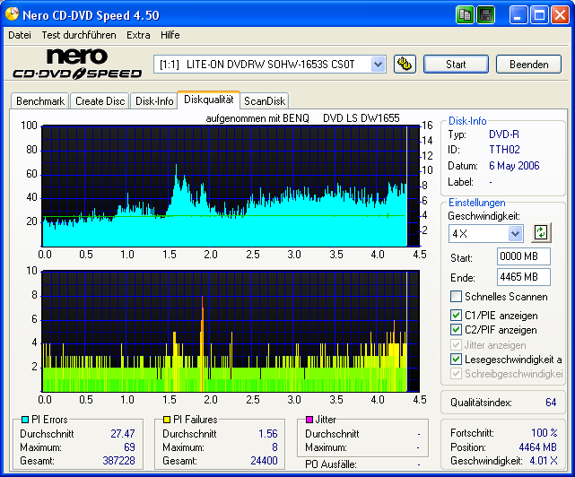

Media-brand: Datawrite Red DVD-R 16x
Media-code: TTH02
Write-speed: 16x
Datawrite Red DVD-R 16x Benq 1655 BCHB B.png (58.88 KiB) Viewed 10390 times
Datawrite Red DVD-R 16x Benq 1655 BCHB L.png (56.32 KiB) Viewed 10391 times

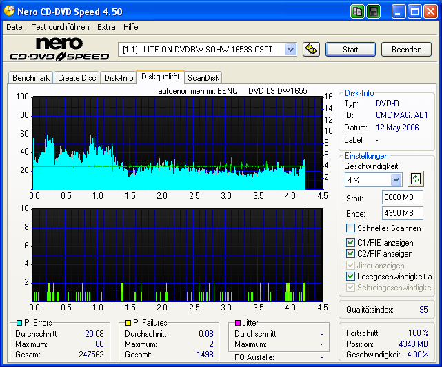

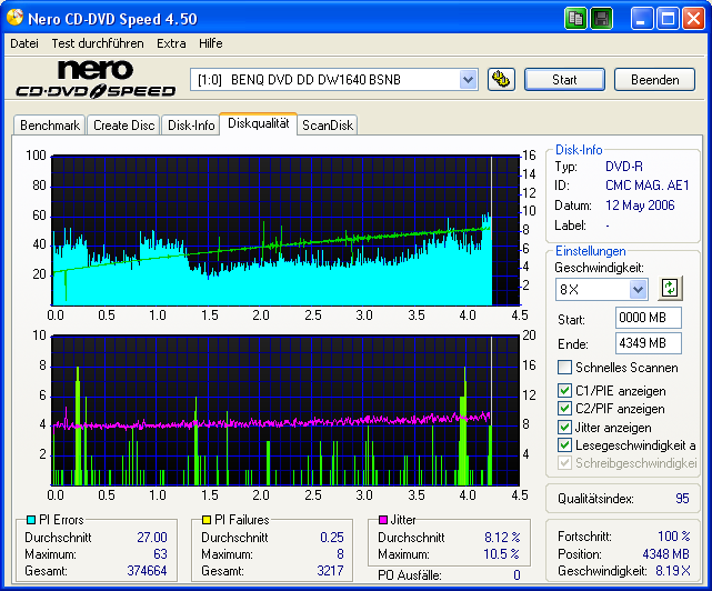

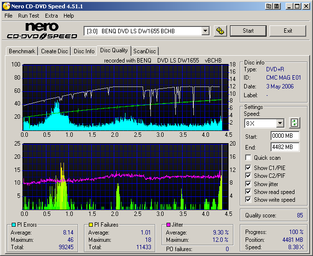

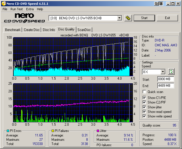

Postby Gabe on Sat Jun 03, 2006 4:17 pm
Media-brand: Datawrite Yellow DVD-R 8x
Media-code: CMC MAG. AE1
Write-speed: 8x
Datawrite Yellow DVD-R 8x Benq 1655 BCHB B.png (56.94 KiB) Viewed 10375 times
Datawrite Yellow DVD-R 8x Benq 1655 BCHB L.png (55.18 KiB) Viewed 10374 times

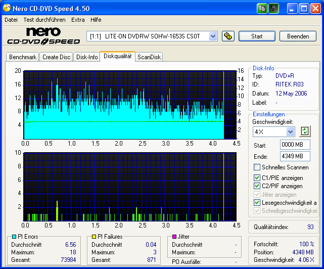

Postby Gabe on Sat Jun 03, 2006 4:18 pm
Media-brand: Fuji DVD+R 8x
Media-code: RITEK R03
Write-speed: 8x
Fuji DVD+R 8x Benq 1655 BCGB B.PNG (56.4 KiB) Viewed 10363 times
Fuji DVD+R 8x Benq 1655 BCGB L.PNG (53.7 KiB) Viewed 10359 times

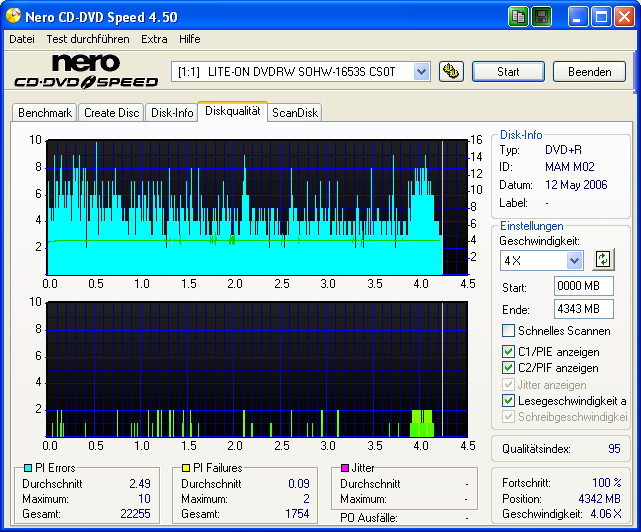

Postby Gabe on Sat Jun 03, 2006 4:20 pm
Media-brand: MAM-E DVD+R 8x
Media-code: MAM M02
Write-speed: 8x
MAM DVD+R 8x Benq 1655 BCGB B.PNG (57.26 KiB) Viewed 10363 times
MAM DVD+R 8x Benq 1655 BCGB L.png (54.7 KiB) Viewed 10350 times

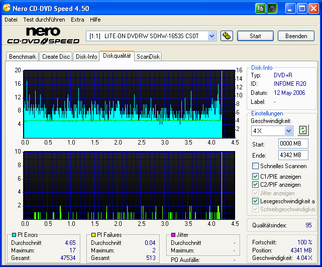

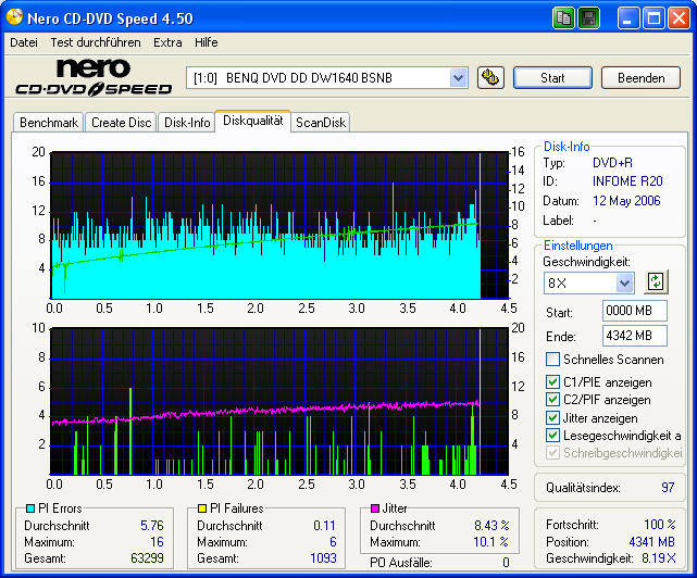

Media-brand: Philips DVD+R 8x
Media-code: INFOME R20
Write-speed: 8x selected, but 4x-burn
Philips DVD+R 8x @4x OPc regelte runter Benq 1655 BCGB B.PNG (56.33 KiB) Viewed 10318 times
Philips DVD+R 8x @4x OPc regelte runter Benq 1655 BCGB L.png (54.28 KiB) Viewed 10314 times

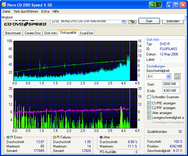

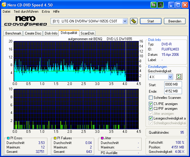

Postby Gabe on Sat Jun 03, 2006 4:35 pm
Media-brand: Ricoh DVD-R 8x
Media-code: FUJIFILM03
Write-speed: 8x
Ricoh DVD-R 8x Benq 1655 BCGB B.png (57.44 KiB) Viewed 10291 times
Ricoh DVD-R 8x Benq 1655 BCGB L.png (54.88 KiB) Viewed 10287 times

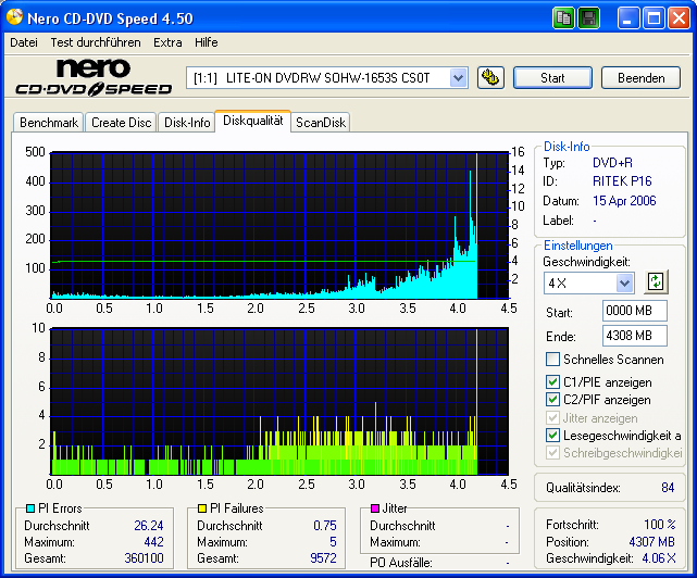

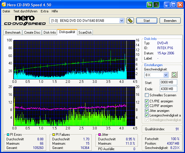

Postby Gabe on Sat Jun 03, 2006 6:03 pm
Media-brand: RiData DVD+R 16x
Media-code: RITEK P16
Write-speed: 16x
RiData DVD+R 16x Benq 1655 BCGB B.png (59.54 KiB) Viewed 10287 times
RiData DVD+R 16x Benq 1655 BCGB L.png (54.9 KiB) Viewed 10273 times

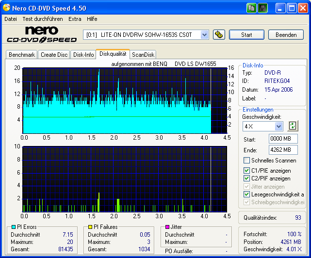

Media-brand: Rivision DVD-R 4x
Media-code: RITEK G04
Write-speed: 4x
Rivision DVD-R 4x Benq 1655 BCGB B.png (55.43 KiB) Viewed 10256 times
Rivision DVD-R 4x Benq 1655 BCGB L.png (54.03 KiB) Viewed 10255 times

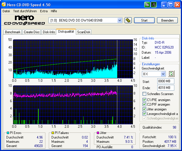

Media-brand: Rivision DVD-R 8x
Media-code: MCC 02RG20
Write-speed: 8x
Rivision DVD-R 8x Benq 1655 BCGB B.png (55.27 KiB) Viewed 10271 times
Rivision DVD-R 8x Benq 1655 BCGB L.png (53.48 KiB) Viewed 10257 times

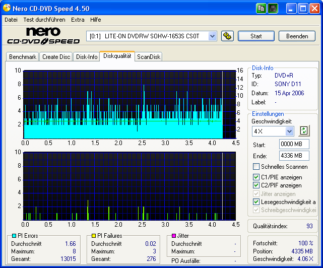

Media-brand: SONY DVD+R 8x Design
Media-code: SONY D11
Write-speed: 8x
Sony DVD+R 8x Benq 1655 BCGB B.png (56.34 KiB) Viewed 10257 times
Sony DVD+R 8x Benq 1655 BCGB L.png (53.87 KiB) Viewed 10244 times

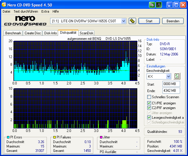

Media-brand: SONY DVD-R 8x
Media-code: SONY08D1
Write-speed: 8x
Sony DVD-R 8x Benq 1655 BCGB B.PNG (57.27 KiB) Viewed 10239 times
Sony DVD-R 8x Benq 1655 BCGB L.PNG (54.94 KiB) Viewed 10236 times

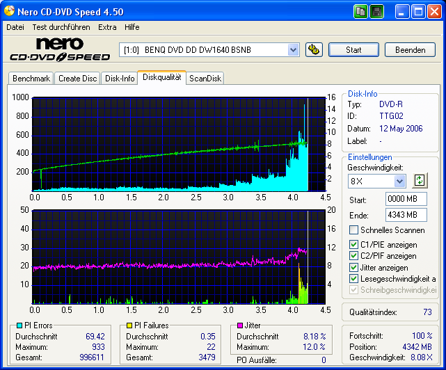

Postby Gabe on Sat Jun 03, 2006 6:17 pm
Media-brand: TDK DVD-R 8x
Media-code: TTG02
Write-speed: 8x
TDK DVD-R 8x Benq 1655 BCGB B.PNG (56 KiB) Viewed 10228 times
TDK DVD-R 8x Benq 1655 BCGB L.PNG (54.54 KiB) Viewed 10215 times
