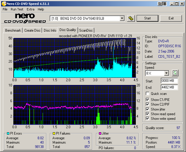

Postby dolphinius_rex on Sun Sep 03, 2006 2:18 am
Acro Circle DVD+R 16X (made in Taiwan) - 50pk Cake Box
MID Code: OPTODISCR16
Burned with:
Pioneer DVR-111D OEM
Firmware: 1.23
Burned at 12x
Scanned with:
BenQ DW1640 OEM
Firmware: BSLB
LiteON SHW-1635S OEM
Firmware: YS0Z

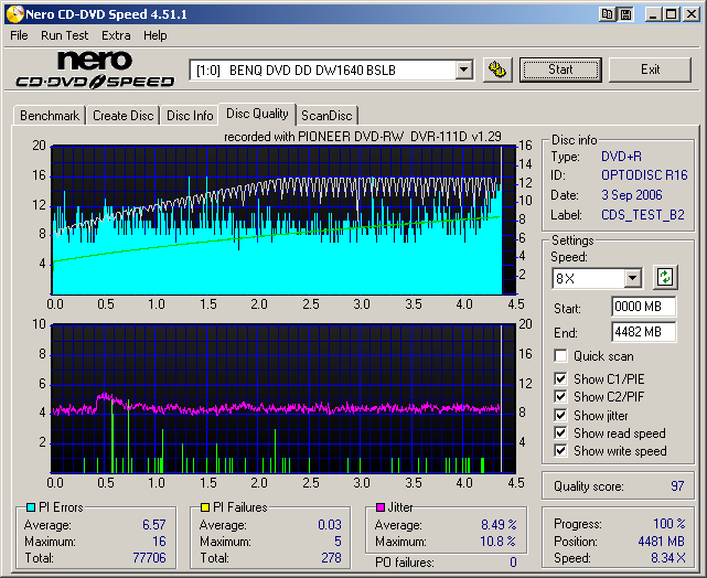

Postby dolphinius_rex on Sun Sep 03, 2006 6:37 pm
Burned with:
Firmware: 1.29
Burned at 16x
Scanned with:
BenQ DW1640 OEM
Firmware: BSLB

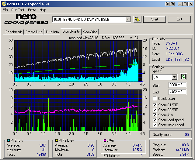

Postby Ian on Sat Sep 30, 2006 11:08 pm
Verbatim 16x DVD+R (MCC 004)
Burned with ASUS DRW-1608P3S (OEM DVR-111) FW 1.24
Written @ 16x
Tested in BenQ DW1640 FW BSLB
Read @ 8x
ASUS DRW-1608P3S Write Quality Verb 16x DVD+R.png (25.97 KiB) Viewed 23274 times

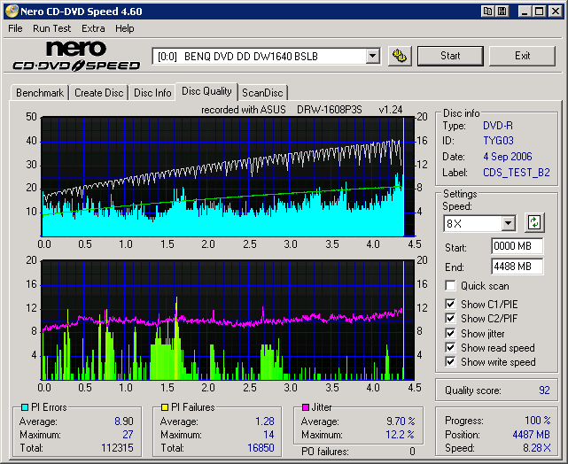

Postby Ian on Sat Sep 30, 2006 11:09 pm
Taiyo Yuden 16x DVD-R (TYG03)
Written @ 16x
Read @ 8x
ASUS DRW-1608P3S Write Quality TY 16x DVD-R.png (23.4 KiB) Viewed 23260 times
