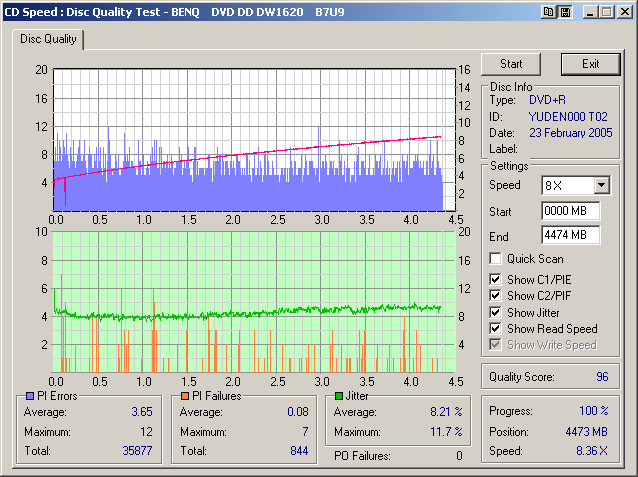

Postby [buck] on Sat Jul 29, 2006 2:55 am
Disc # 003
Fujifilm DVD+R 8X (Made in Japan)
YUDEN000T02 burned @ 12X in BenQ DW1620 B7U9
Burned: late February 2005
Rescanned: July 04 2006
Stamper serial: TG001133 1602
Stored in poor quality DVD case

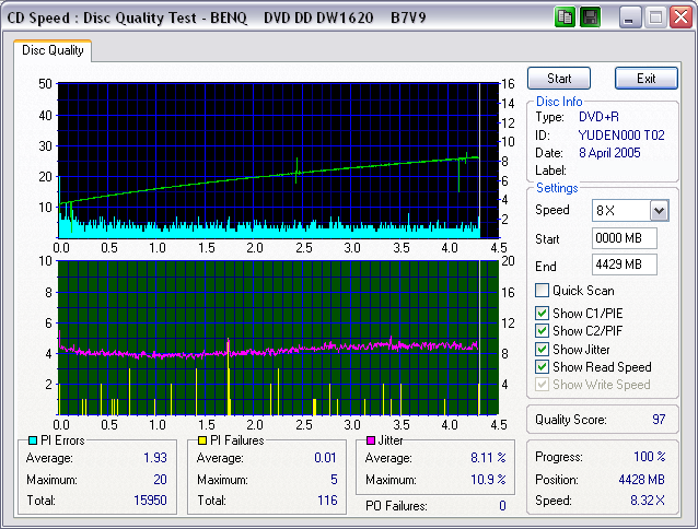

Disc # 005
YUDEN000T02 burned @ 12X in BenQ DW1620 B7V9
Burned: late April 2005
Rescanned: July 13 2006
Stored in Case Logic wallet

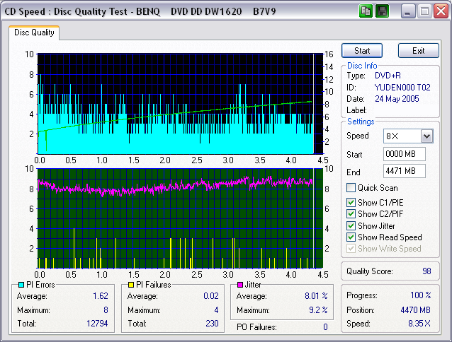

Disc # 006
Burned: early June 2005
Rescanned: July 18 2006
Stamper serial: TG001159 0604

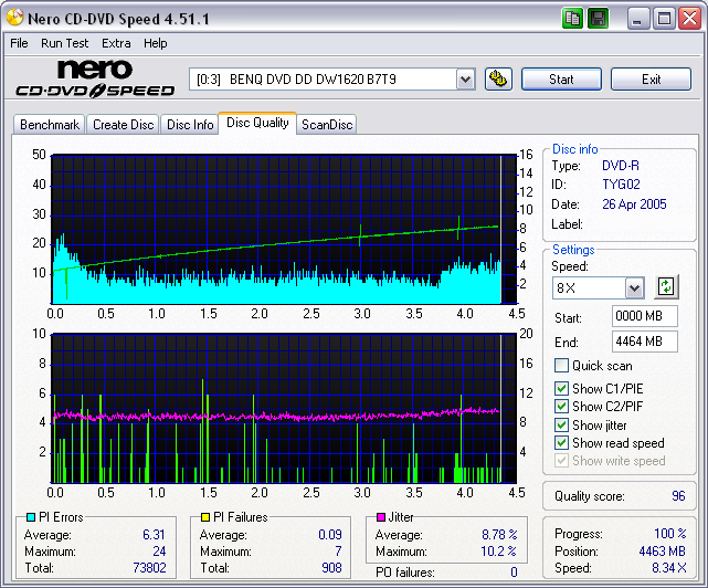

Postby [buck] on Sat Jul 29, 2006 3:01 am

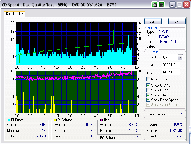

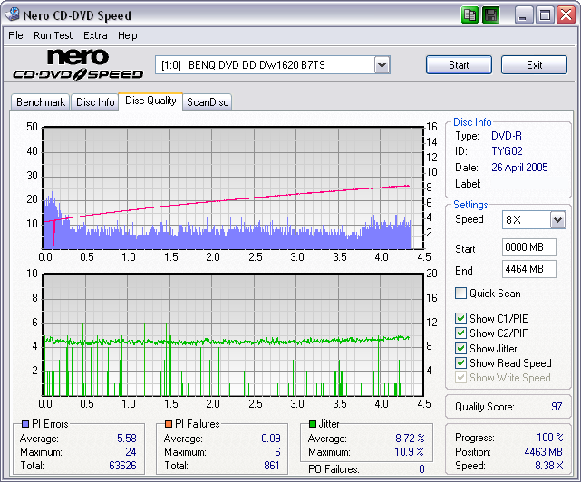

Disc # 009
Fujifilm DVD-R 8X (Made in Japan)
TYG02 burned @ 8X in BenQ DW1620 B7T9
Burned: early May 2005
Stamper serial: GG000103 0501

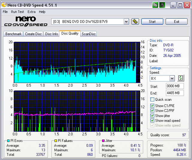

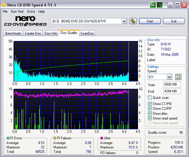

Postby [buck] on Sat Jul 29, 2006 3:02 am
Disc # 010
TYG02 burned @ 8X in BenQ DW1620 B7V9
Burned: early April 2005
Rescanned: July 05 2006

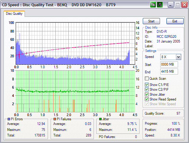

Postby [buck] on Sat Jul 29, 2006 3:04 am
Disc # 012
Verbatim DVD-R 8X Silver Thermal Printable (made in Taiwan by Prodisc)
MCC02RG20 burned @ 8X in BenQ DW1620 B7T9
Burned: mid December 2004
Rescanned: July 17 2006

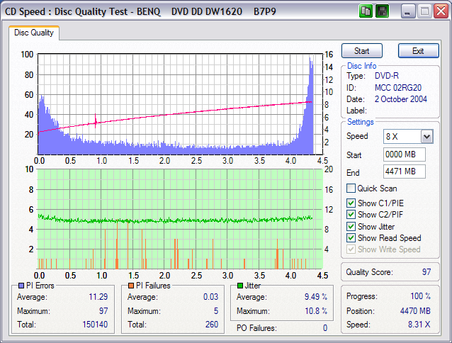

Postby [buck] on Sat Jul 29, 2006 3:05 am
Disc # 014
MCC02RG20 burned @ 8X in BenQ DW1620 B7P9
Burned: December 2004

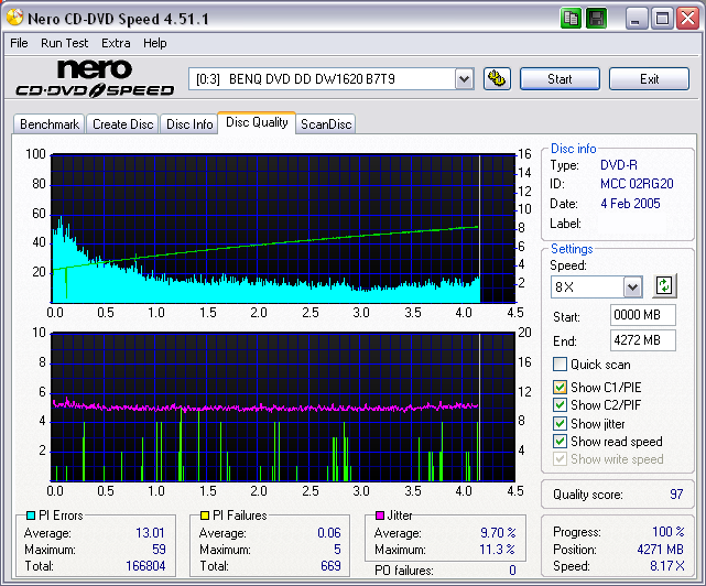

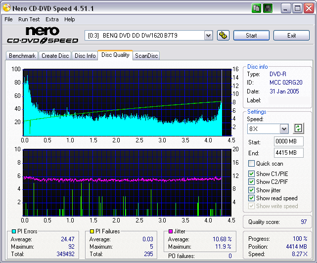

Postby [buck] on Sat Jul 29, 2006 3:07 am
Disc # 016
Burned: early February 2005

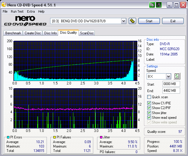

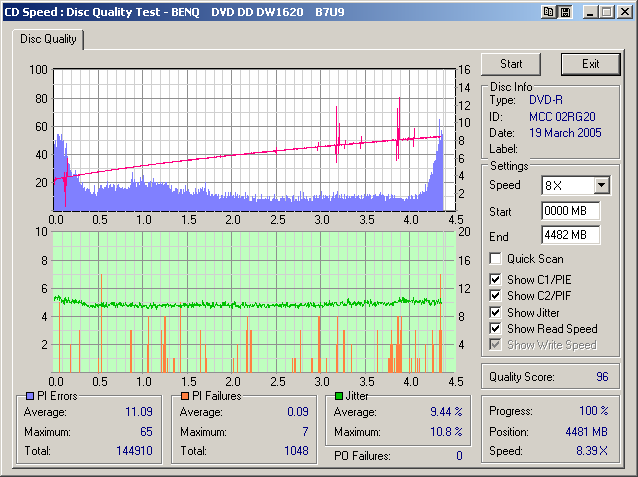

Disc # 020
MCC02RG20 burned @ 8X in BenQ DW1620 B7U9

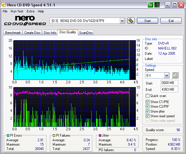

Postby [buck] on Sat Jul 29, 2006 3:13 am
Disc # 022
Maxell DVD+R 8X (Made in Japan)
MAXELL002 burned @ 8X in BenQ DW1620 B7P9
Burned: mid April 2005
