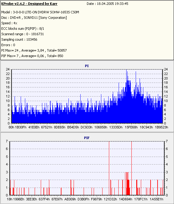

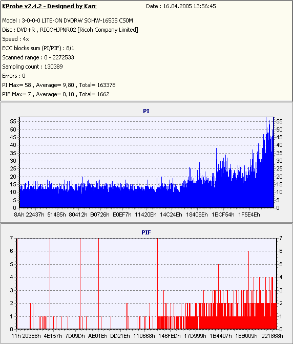

Yeah, Benq-drives don´t like higher jitter and shows sometimes very high PIF in critical jitter-zones.
But the LiteOn shows these spikes, too, and LiteOn isn´t very sensitive when a media have higher jitter.
But these spikes are sometimes on media that´s burned with my NEC 3500 (and some other NECs, too)
