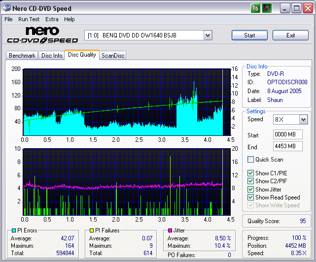

Postby wicked1 on Fri Aug 12, 2005 2:21 pm
here is a transfer test of a disc that got a pretty good quality score.
BENQ transfer rate test.png (32.16 KiB) Viewed 2590 times
here is the scan
Optodisc transfer rate test disc quality scanned.png (34.06 KiB) Viewed 2592 times

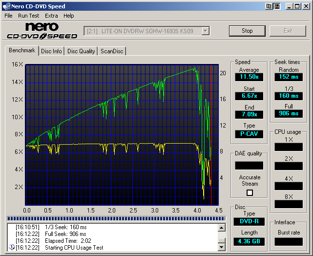

Postby wicked1 on Fri Aug 12, 2005 2:23 pm
here is another optodisc doing a tranfer rate test in my liteon 1693S
Optodisc transfer rate test.png (31.82 KiB) Viewed 2586 times

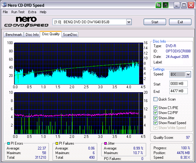

Postby wicked1 on Fri Aug 12, 2005 2:29 pm
This disc scores well but wont playback in my LiteON set top player or my XBOX. It starts but skips and stutters badly. It has a bad transfer rate test too.
Unplayable optodisc burnt in 1640.png (33.5 KiB) Viewed 2583 times
