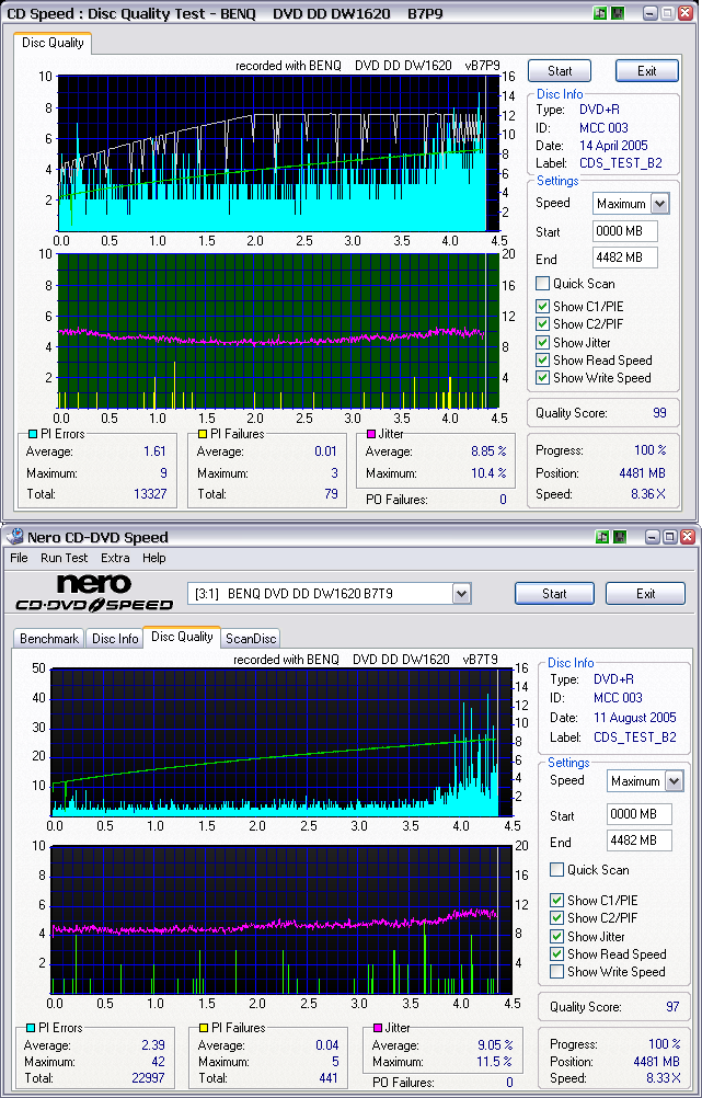

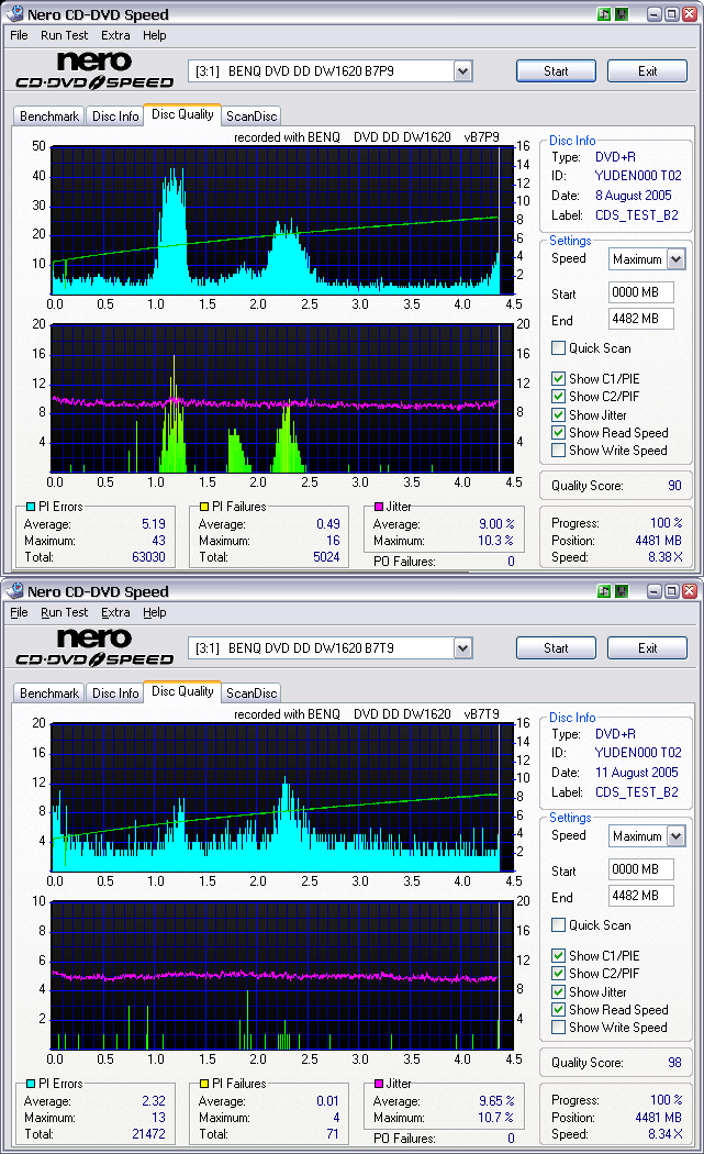

OK updated to B7T9 and here are the results.
3 pics, each of CD test data discs, everything burned at 8x.
the top snapshot in each pic is B7P9, the bottom is B7T9.
it appears that B7T9 is much better for the TY T02, but B7P9 is better for my Prodisc-made-Verbatiom MCC003. :o :x
so now what? reflash the drive every time i take media from a different spindle ??? :evil:

also, obviously quite a difference in quality between the two Verbatim spindles i got.

MID: YUDEN000 T02 (000)

MID: MCC 003
misc media info: made in India by MBIL, straight lipped spindle cakebox
brand: Verbatim DataLifePlus Advanced AZO
type: DVD+R (X47B)
speed rating: 8x
MID: MCC 003
misc media info: made in India by MBIL, round lipped spindle cakebox

Dodeca, stick with T9. Those MCC003 results aren't that bad at all, and those Yuden scans look positively schweet with T9.
Postby dodecahedron on Fri Aug 12, 2005 1:36 am
Bhairav wrote:Dodeca, stick with T9. Those MCC003 results aren't that bad at all, and those Yuden scans look positively schweet with T9.
re the MCC scans aren't bad at all: i really have no experience etc. so i'll take your word for it.
but still the B7P9 are better on the MCC, wouldn't you agree? the first verbatim pic above. the difference is quite marked!
how about B7U9 and B7V9? not as good as B7T9?

Yep, the first MCC003 burns are quite different - 5 times the PI errors! Still, if readability is fine, I'd go with T9 (personal opinion :wink: )
