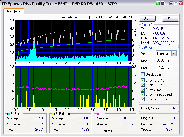

here are some scans.
all discs are Verbatim DataLifePlus 8x certified, burned at 12x, burned and scanned on BenQ DW1620 B7P9
brand: Verbatim DataLifePlus Advanced AZO
type: DVD+R (X47B)
speed rating: 8x
MID: MCC 003
misc media info: made in India by MBIL, straight lipped spindle cakebox
1005 BENQ____DVD_DD_DW1620_B7P9_01-May-2005_10_07_scan1.png (49.17 KiB) Viewed 5106 times

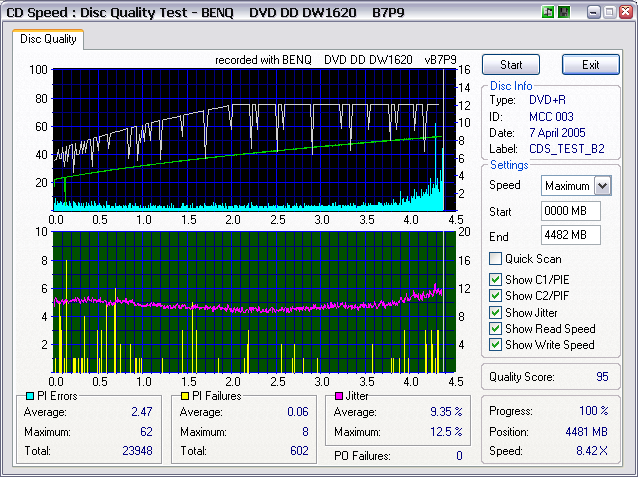

type: DVD+R (X47B)
speed rating: 8x
MID: MCC 003
misc media info: made in India by MBIL, round lipped spindle cakebox
1004 BENQ____DVD_DD_DW1620_B7P9_14-April-2005_14_01_scan1.png (48.39 KiB) Viewed 5091 times
