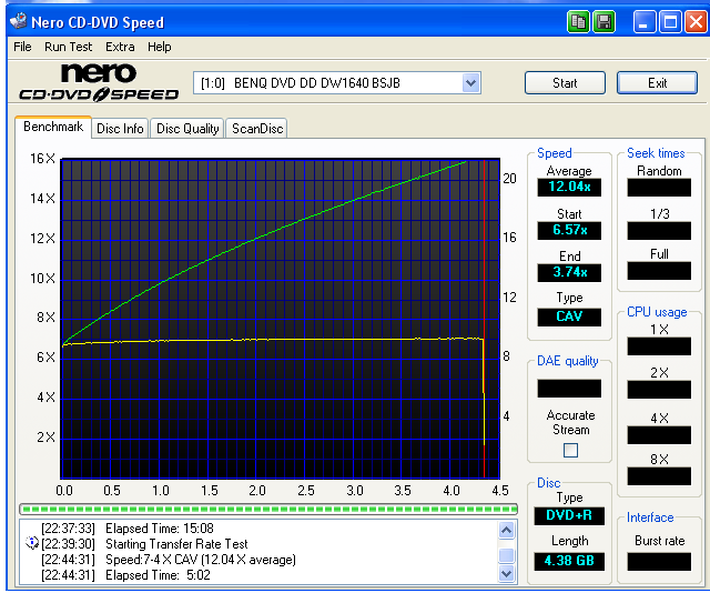

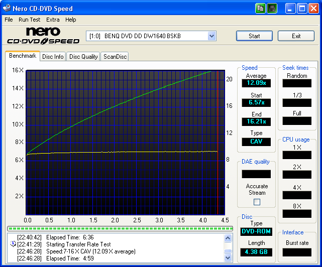

Postby TCAS on Thu Aug 11, 2005 12:32 am
This is the ripping speed (Transfer Rate) using D/L pressed DVD Video disk. after using ala42 MiediaCodeSpeedEdit:

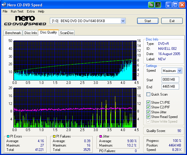

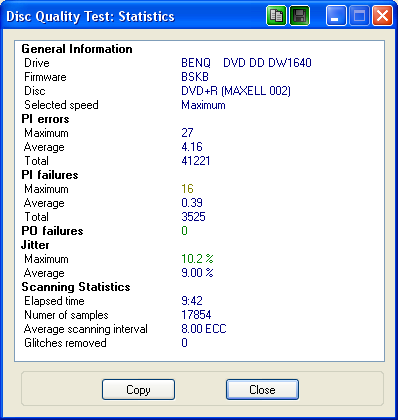

Postby TCAS on Tue Aug 16, 2005 9:53 pm
Just upgraded to new BenQ BSKB, burned the first D/L Pressed Video DVD to Maxell DVD+R (8X) 002 burned at 16X with "OverSpeed" on and "SolidBurn" activated.

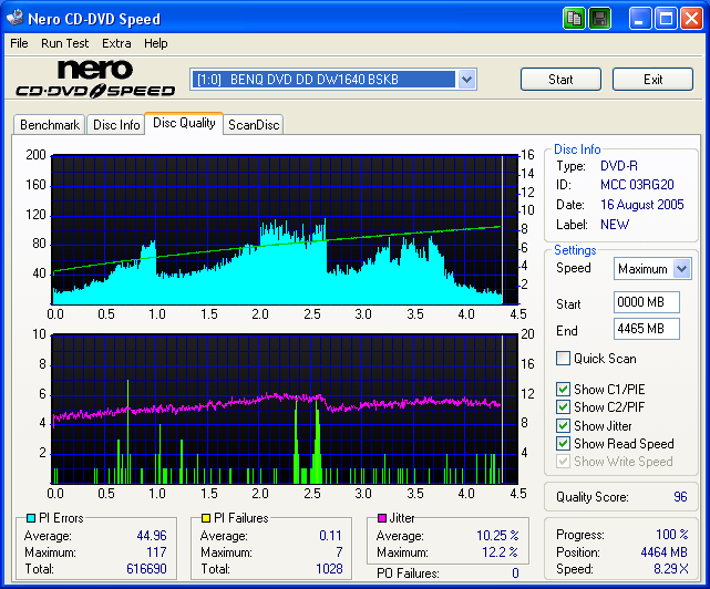

Postby TCAS on Tue Aug 16, 2005 11:06 pm
This time Burned NexXtech (Manufactured by Verbatim)DVD-R (8X) MCC 03R G20 burned @nearly 12X again SolidBurn activated and OverSpeedon
