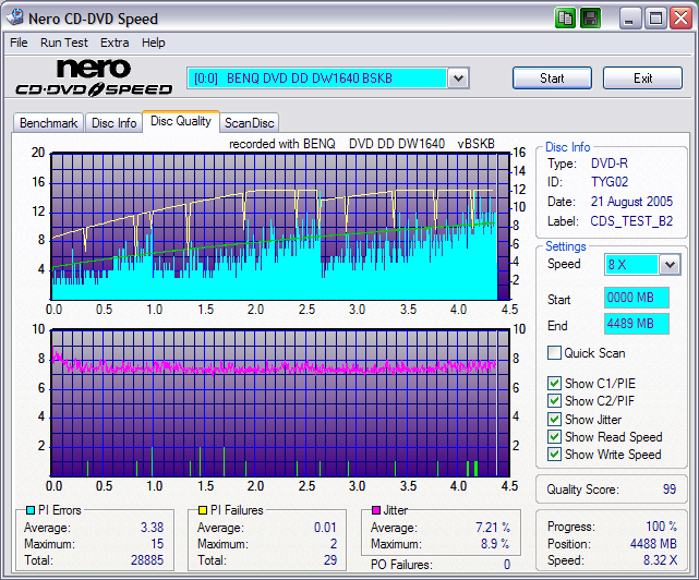

Postby wicked1 on Fri Aug 19, 2005 11:11 pm
here is another TYG02 burnt without overspeed and without solidburn burn.
BENQ 1640 BSKB TYG02 burnt at 8X no solidburn or overspeed BENQ scan.png (33.56 KiB) Viewed 300 times

Postby TCAS on Sat Aug 20, 2005 1:42 am
Yes remember the biggest concern people had prior to release of BSKB was inability of 1640 not to overspeed the media above thier rated speed, if you turn the overspeed off then what is the purpose of having BSKB?.
Postby wicked1 on Sat Aug 20, 2005 10:50 am
I did a strategy swap with TYG02 and TYG03 using MCSE and then burnt the disc at 16X and got better results than using overspeed to burn my TYG02 at 16X..

Postby TCAS on Sun Aug 21, 2005 12:32 am
Yes but the problem with using MCSE for buring speed increase is you have to each time mess with swapping the writing strat from one media to antherone and that could cause trouble at some point.
Postby wicked1 on Sun Aug 21, 2005 1:42 am
TCAS wrote:Yes but the problem with using MCSE for buring speed increase is you have to each time mess with swapping the writing strat from one media to antherone and that could cause trouble at some point.
agreed. For the time being however it appears the TY swap works better than the overspeed on TYG02 media if you must burn at 16X. Personally my backups are burnt at 8X as the quality is fantastic and the extra minute means nothing . Hopefully another firmware will help. BSKB made a huge jump forward on my TYG03 discs. It almost burns the same as my NEC now.
