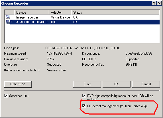

Could the BD-RE 2X disk limit write speed to 1X even though you can select a 2X speed in the recording software (Nero, ImgBurn)?

Nero automatically verifies the data so it looks like its writing at 0.9x instead of 2x. I think there's an option to disable that but I don't know what it is off the top of my head.

If you want to try Imgburn, you need to check this box:

I believe this is the option you want to look for in Nero. You'll want to uncheck it.
Nero BD Defect Management.png (9.67 KiB) Viewed 8887 times
Re: BD-RE 2X buring slow at 1X....LG GGW-H20L
Postby MichaelT1960 on Tue Oct 21, 2008 10:25 pm
Ian,
You are a genius! :D :D :D I now am able to write at 2.2X with the BD-RE disk! How come couldn't anyone else solve this problem including LG's Tech Support?
