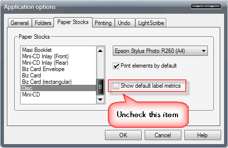

3. There is a problem, however, and that is the larger diameter circle itself is printed even though the inner diameter has been changed. See the screenshot below. I have an uneasy feeling that there is no way to remove this part of the template or to make an modification to the template so it doesn't print.
Addendum: I resolved #3. I found what I was looking for under "File/Options" - "Paper Stocks" (tab). Simply uncheck "Show default label metrics".
