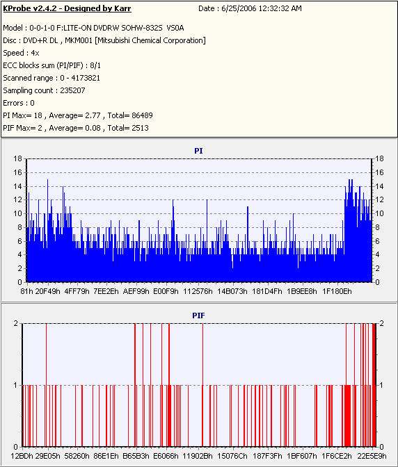

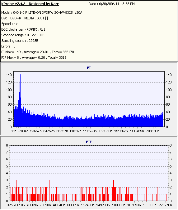

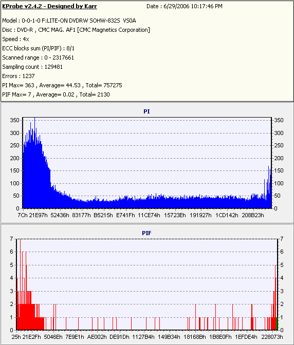

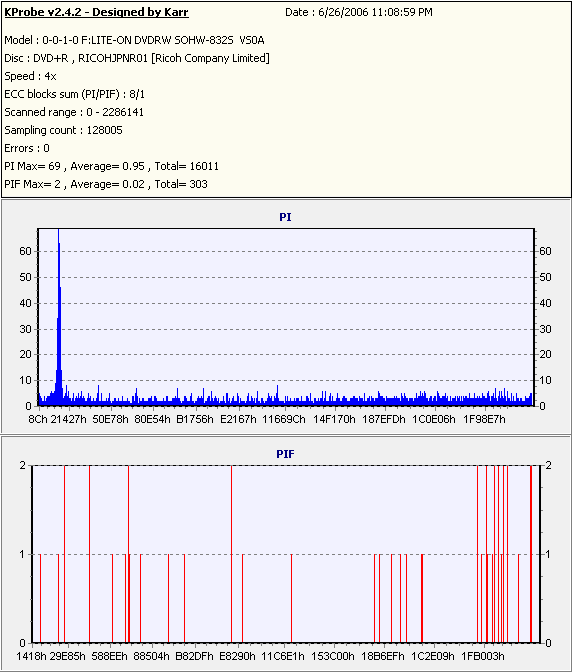

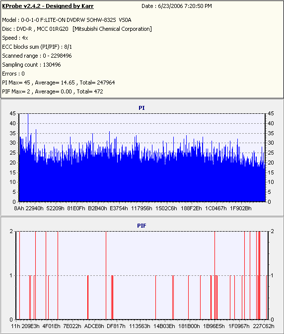

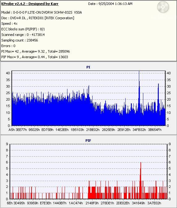

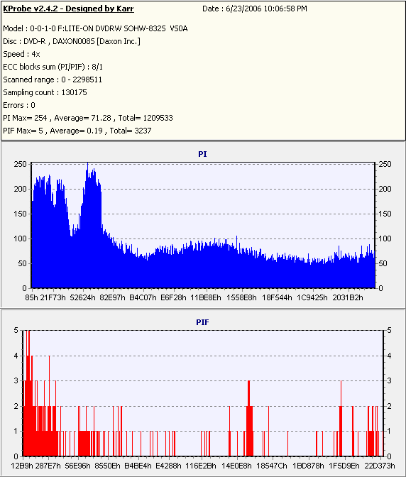

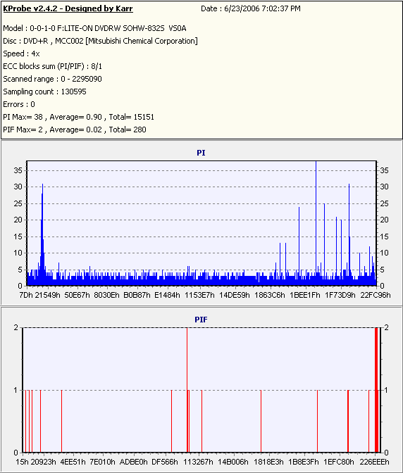

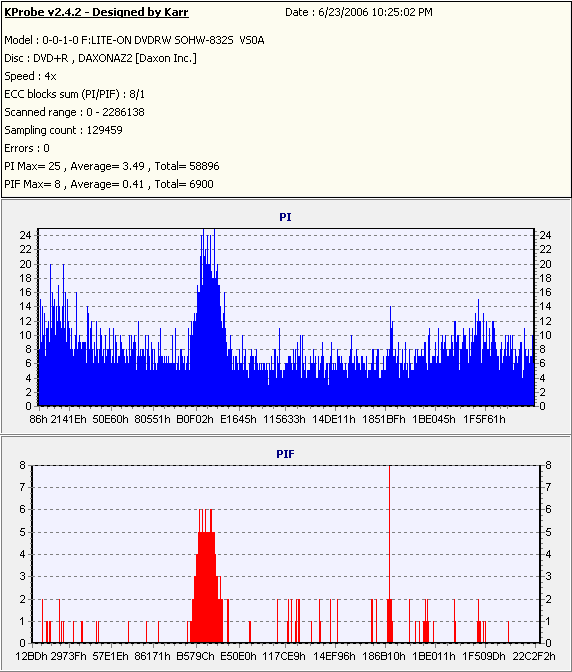

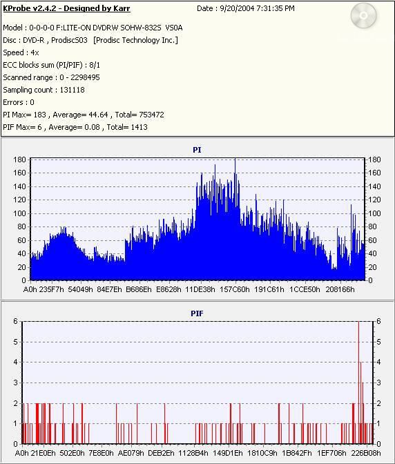

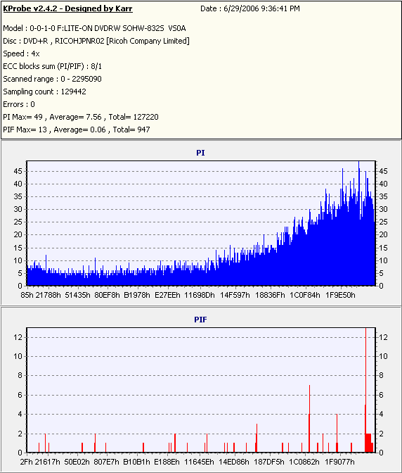

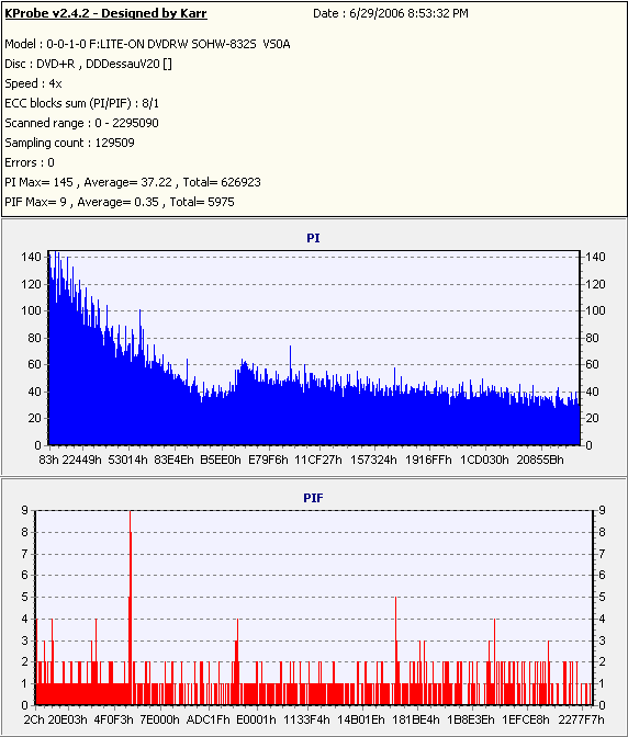

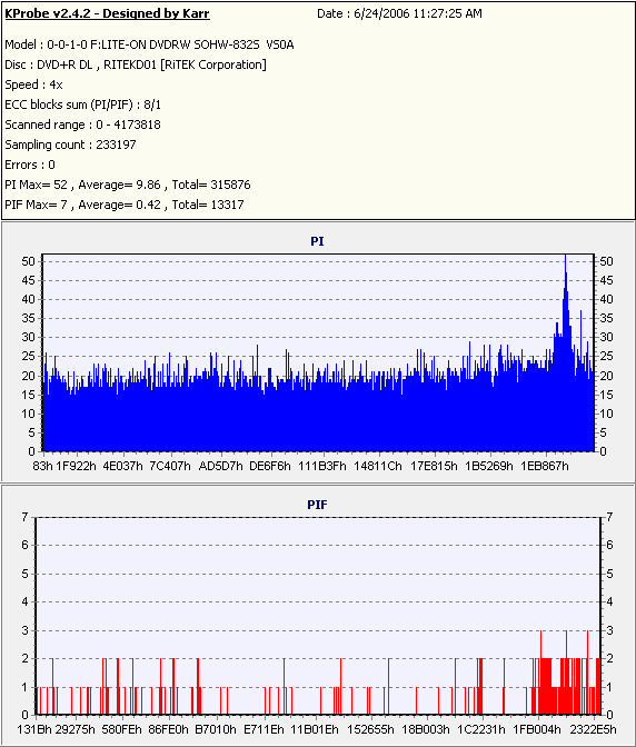

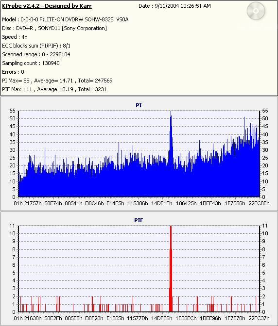

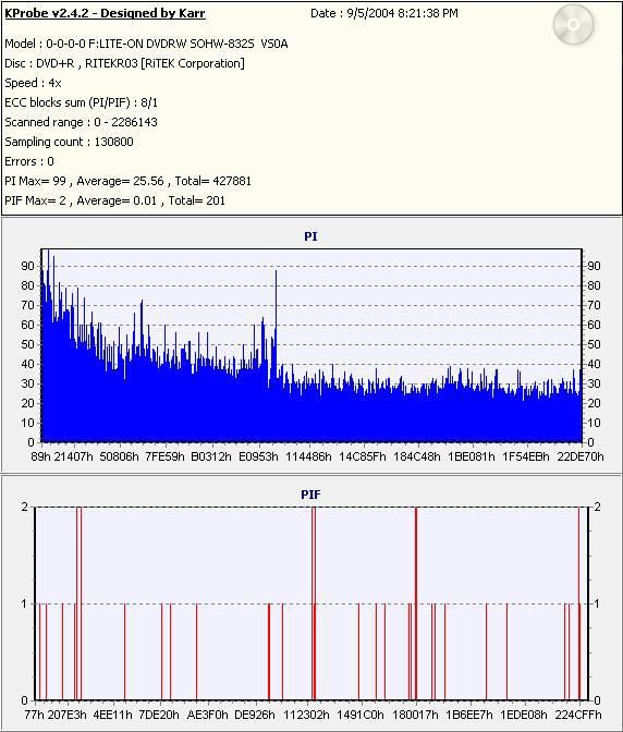

As promised, this is my latest run of longevity tests. All discs were burned on my BenQ DW1620 in mid to late september of 2004. All original scan were done with the LiteON LTN-832S, running firmware VS0A, using K-Probe 2.4.2. All followup scans were *ALSO* run using the same LTN-832S running firmware VS0A, and K-Probe 2.4.2. Thank you to MediumRare for assisting me in getting both the firmware *AND* the version of K-Probe needed.
First picture is the original scan done when making my BenQ DW1620 review, and the second picture is the followup scan made in the last few days.

Postby MacClipper on Mon Jul 03, 2006 11:08 pm
Thank you for all this work.
The TY T02 seems to be showing some edge degradation aleady, kind of worrying for what is perceived as a top quality media. Are your other T02s exhibiting this degradation too?
btw, from personal experience Daxon media quality is very variable and your samples seem to wear well but I have quite a few which has degraded rather drastically.

Postby dolphinius_rex on Tue Jul 04, 2006 2:28 am
MacClipper wrote:Thank you for all this work.
So far most of my Taiyo Yuden media, (4x, 8x and 16x DVD-Rs, and 8x DVD+Rs), have shown considerable degridation in almost every case. Unfortunately, I only have about 5 or 6 discs that can truly be considered test samples (and only the 1 of 8x DVD+R).
As you say, I've also found Daxon media to age quite inconsistantly. Some don't age at all, but others are quite the opposite.
