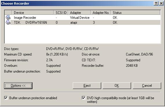

Postby snubby on Wed Aug 10, 2005 8:30 pm
I am using TDK 1616DLN burner. Can you tell me how do I choose the recorder-properties in Nero. I can't find this option in my Nero.

Postby Scour on Wed Aug 10, 2005 8:38 pm
Klick on the to the right of the pulldown where the name of the recorder is or "choose recorder" in the recorder-menu. In the window that now showed you can open a advanmced menu (don´t know the name, my Nero is german)
Your recorder is an NEC 3500-OEM, don´t know if it can booktype-setting, NEC 3500 can do it only with the newest Firmware.

Postby snubby on Thu Aug 11, 2005 8:46 pm
Thanks for your respond, but there is no "Advance setting" under my choose recorder screen.

Postby dodecahedron on Fri Aug 12, 2005 1:29 am
click the Options button.
Postby snubby on Fri Aug 12, 2005 11:35 am
. Buffer underrun protection enabled
. DVD high compatibility mode (at least 1GB will be written)
That is what i see when i click "Options"

Postby dodecahedron on Fri Aug 12, 2005 11:49 am
well, this is what i see when i click the Options button.
it seems that your drive does not support booktype setting (bitsetting).
at least not with the firmware you have now.
there might be other firmwares for the drive that do have this feature.
try checking up at rpc1.org.
Postby Scour on Fri Aug 12, 2005 12:04 pm
snubby wrote:. Buffer underrun protection enabled
That means that the TDK don´t can bitsetting with Nero :(
Maybe you can crossflash your TDK to a NEC, but it voids the guarantee:
http://club.cdfreaks.com/showthread.php ... t=tdk+1616
Postby TCAS on Fri Aug 12, 2005 3:33 pm
Snubby; First welcome to CDRLabs, the best and easy way to set the book type just open your Nero CDSpeed program go to the tools and open the booktype make sure your drive shows at the window then try to set the DVD+R, DVD+RW to DVD-ROM click OK and that is it.
