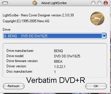

This thread has been very helpful for getting my BenQ DW1625 working. I have Verbatim LightScribe CD-Rs and DVD+Rs and was getting pretty frustrated with the DVDs until I found this thread. I got the drive to label the DVD+Rs by going to:
http://www.surething.com/ST/Category.as ... BE_SUPPORT
This works for me using both EasyMedia Creator 7.5 and Nero Cover Designer 2.3. I attached a similar screen shot as one of the prior posts and you can see the LightScribe version number is higher (1.0.22.1 compared to 1.0.13.1 from Nero).
LightScribe in Nero Cover Designer with Verbatim DVD+R in BenQ

thanks naschmitz...!!! got it working after installing the surething host update
