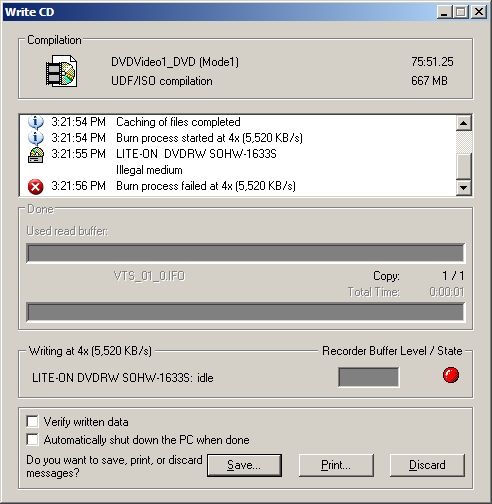

Postby P.D. Nelson on Wed Jun 14, 2006 6:32 pm
I have Nero 5.5.10 I am trying to burn a DVD using files that I have converted from WMF to DVD video files (Video_TS.BUP, Video_TS.IFO, Video_TS.VOB etc..) I'm using a Lite On DVDR/RW Combo drive everything proceeds until I do the write CD and I get this message:

Postby dodecahedron on Wed Jun 14, 2006 9:48 pm
post the log. it will help diagnose the problem.

Postby P.D. Nelson on Thu Jun 15, 2006 2:29 pm
Here is the log file from the latest try.

Postby dodecahedron on Thu Jun 15, 2006 2:30 pm
don't upgrade to Nero 7, it's still buggy.
use Nero 6 (the latest version 6.6.1.4).
Postby CCampbell on Thu Jun 15, 2006 5:24 pm
The log file shows a communication problem either with the Recorder, or the VIA IDE controller, as seen by the below error message...

Postby P.D. Nelson on Fri Jun 16, 2006 1:09 am
Gentlemen I thank you for your help I believe I've found my issue. Seems my burner won't burn 16x DVD-r and I've checked with the rest of my stuff ans sure enough it was a 8x DVD-r and I've investigated this particular drive on the net, not a lot of good things to say about it but the man thing was nothing above 8x DVD-R can be burnt on the thing.

Postby MediumRare on Fri Jun 16, 2006 7:40 am
I'm curious- you talk about a CD and the size of your video is certainly compatible with a CD, but the disc you actually used is a DVD? Are you sure that you set up your compilation for a DVD? On the other hand, the Nero log also repeatedly refers to both CD's and DVD's :o, but that may be the ancient version 5.x you're using.
I would definitely try Nero 6. Your drive should have come with an OEM version of Nero 6- dig that up and use it...

Well first let me tell you've upgraded to Nero 6 (another oem disk I had) and it was at the codeguys forum that I learned about my particular player and how lame it is. I also tried (not that one I'll grant you) their flash thing to change my BGS4 to something else but I still got no love with my 16x disks. So I've given them to my son who has no troubles and I'll just burn to my 8x of which I bought 30 for $12.00 at a discount store.
Oh yes I did make sure it was DVD also.
BTW how do you find out the media version?
MediumRare wrote:I'm curious- you talk about a CD and the size of your video is certainly compatible with a CD, but the disc you actually used is a DVD? Are you sure that you set up your compilation for a DVD? On the other hand, the Nero log also repeatedly refers to both CD's and DVD's :o, but that may be the ancient version 5.x you're using.
Your LiteOn SOHW-1633S will burn 16x DVD-R media- although not at 16x! I own a 1213S, now crossflashed to 1653S (fw CS0T) and have successfully burned 16x DVD-Rs. If you're willing to void your warrantee (which means "don't send it to LiteOn if it gets broken") you can crossflash your drive to a 1653S (the hardware is the same). The CS0T firmware is the best available for the 3S series of drives. Use this firmware from the codeguys's site and have a look at further tools and information available there while you're at it- it's well worthwhile!
Also Ritek media can be iffy- try Verbatim (MCC) or Taiyo Yuden.

Postby hoxlund on Fri Jun 16, 2006 5:14 pm
to find the media version you can use quite a few programs
nero infotool is what i usually use, its built into cdspeed as well
cd/dvd info pro has it
