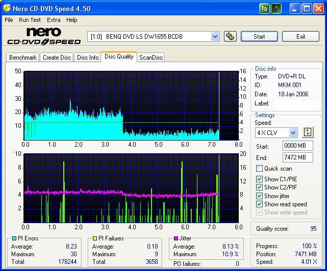

Postby VideoRoy on Wed Mar 29, 2006 12:30 am
Burned with PX-716A FW 1.09
Verbatim DVD+R DL - MKM 001 - Made in Singapore
Written @ 2.4x
Tested in DW1655 FW BCDB @ 4x CLV
DRU500A-2.1A, DRU710A-BYX5, PX716A-1.11, DW1655-BCIB, LH-20A1H-LL0C, GMA-4080N-0S35
Pioneer DVR-633H-s
VideoRoy
Posts: 161
Joined: Sat Jan 08, 2005 12:39 am
Postby Scour on Thu Jan 18, 2007 7:23 pm
http://www.cdrlabs.com/phpBB/viewtopic. ... 105#164105
This is the only burn u post thats very good imho. The others are still good, but PIF-total <1000 and the cluster are not good enogh for this media.
I´m not sure is this the writers fault or u have some batches of media with not so good quality
